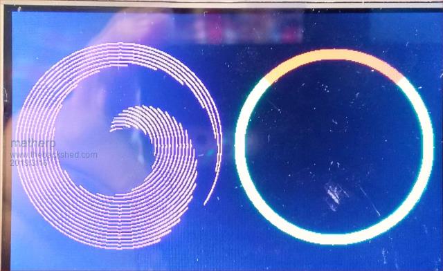

This contains two new drawing commands.
ARC x, y, r1, [r2], rad1, rad2, colour
Draws an arc of a circle of a given colour and width between two radials (defined in degrees). Parameters for the ARC command are:
x: X coordinate of centre of arc
y: Y coordinate of centre of arc
r1: inner radius of arc
r2: outer radius of arc - can be omitted if 1 pixel wide
rad1: start radial of arc in degrees
rad2: end radial of arc in degrees
colour: Colour of arc
CLS
For i=0 To 99 Step 4
Arc 120,150,20+i,,325+2*i,5+5*i,RGB(magenta)
Next i
Arc MM.HRes\4*3,150,100,110,315,45,RGB(red)
Arc MM.HRes\4*3,150,100,110,45,315,RGB(green)
and

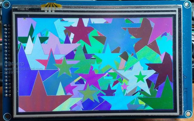

POLYGON xarray%(), yarray%() [, bordercolour] [, fillcolour]
Draws a outline or filled polygon defined by the x,y coordinate pairs in xarray%() and yarray%(). If fill colour is omitted then just the polygon outline is drawn. If bordercolour is omitted then it will default to the current gui foreground colour. The polygon should be closed with the first and last elements the same. The size of the array must exactly match the number of x,y coordinate pairs.
See the video of the example code running on the Armmite H7. The MMX is slower but still very usable.
option explicit
option default none
dim x%(9),xd%(9)
dim y%(9),yd%(9)
dim integer i,c,f, xp, yp
dim float s
cls
for i=0 to 9 step 2
x%(i)=-(SIN(rad(i*36))*200)
y%(i)=-(COS(rad(i*36))*200)
x%(i+1)=-(SIN(rad((i+1)*36))*76)
y%(i+1)=-(COS(rad((i+1)*36))*76)
next i
do
c=rnd()*255 + ((rnd()* 255)<<8) + ((rnd()* 255)<<16)
f=rnd()*255 + ((rnd()* 255)<<8) + ((rnd()* 255)<<16)
xp=rnd()*mm.hres
yp=rnd()*mm.vres
s=rnd()
for i=0 to 9
xd%(i)=x%(i)*s+xp
yd%(i)=y%(i)*s+yp
next i
polygon xd%(), yd%(), c, f
loop
