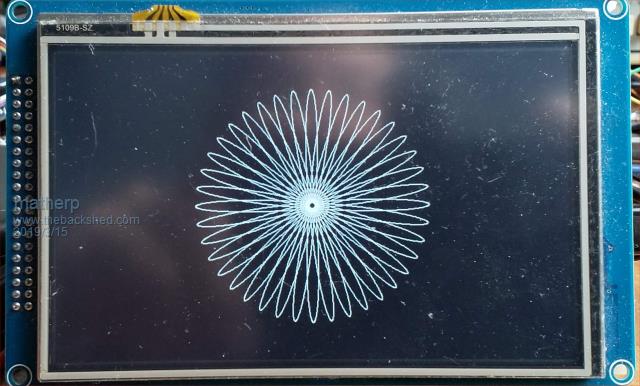

Try running the following extremely simple code
example data on SSD1963: 200,170,80
Option explicit
option default NONE
dim float x,y,t
dim float a, b, p
input "params a,b,p :",a,b,p
cls
do
x=(a-b)*cos(rad(t))+(b-p)*cos((a-b)/b*rad(t))+mm.hres\2
y=(a-b)*SIN(rad(t))-(b-p)*SIN((a-b)/b*rad(t))+mm.vres\2
pixel x,y
t=t+1
loop while not loc(0)

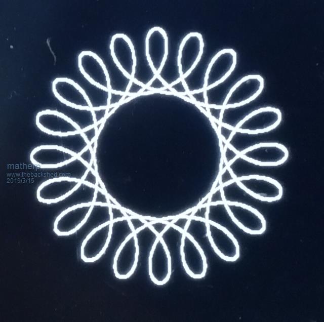

Here is a modified version which uses a recursive calculation of the greatest common denominator of a and b to predict how many petals the design will have and automatically terminates the program when the complete pattern is drawn.
I've put a short pause in the loop so you can see the pattern drawing
Option explicit
Option default NONE
Dim float x,y,x0,y0, t
Dim float a, b, h
dim integer d
Input "params a,b,h :",a,b,h
d=gcd(a,b)
Print "Pattern will have ",a\d," petals"
CLS
x0=(a-b)*Cos(Rad(0))+(h)*Cos((a-b)/b*Rad(0))+MM.HRes\2
y0=(a-b)*Sin(Rad(0))-(h)*Sin((a-b)/b*Rad(0))+MM.VRes\2
For t=1 To (a\d-1)*360
x=(a-b)*Cos(Rad(t))+(h)*Cos((a-b)/b*Rad(t))+MM.HRes\2
y=(a-b)*Sin(Rad(t))-(h)*Sin((a-b)/b*Rad(t))+MM.VRes\2
LINE x0,y0, x,y
x0=x
y0=y
Pause 1
Next t
Function gcd(a As integer, b As integer)As integer
' returns greatest common denominator of two numbers
If(b=0)Then
gcd=a
else
gcd=gcd(b, a mod b)
EndIf
End Function
200,105,90

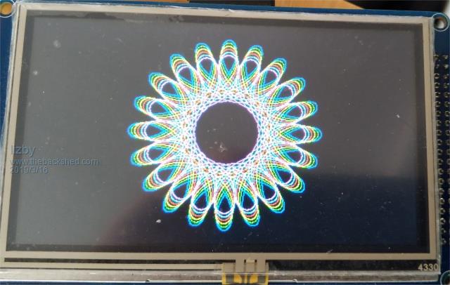

  paceman said  ... I played colours with your first code
Nice on a 4.3" SSD1963 on an H7 backpack-144:
But I got this:
save "spirograph2.bas"
> run
parameter inc = 4
[22] Pixel x,y,culla(z)
Error: Index out of bounds
Don't know what more should have appeared.

Nothing more Lance, that was it. I was lazy finishing it off. I'm using a 4.3" SSD1963 too - did using inc=2 make your eyes go a bit weird too?

  lizby said   But I got this:
> run
parameter inc = 4
z should maybe wrap around instead of going on incrementing, or the program should stop when it reaches the size of culla()
JohnEdited by JohnS 2019-03-17

OK, a quick wrap-around. Add the line below as the second last line, i.e before the 'GOTO change'.
If z=6 then z=0
Stop it with a ctrlZ when you think it's pretty enough.

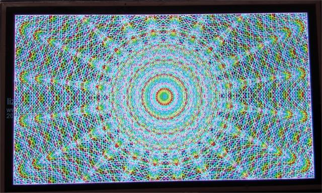

Interesting indeed, but it would take a video to do it justice with either inc=4 or inc=2.
Ctrl-C terminates.
