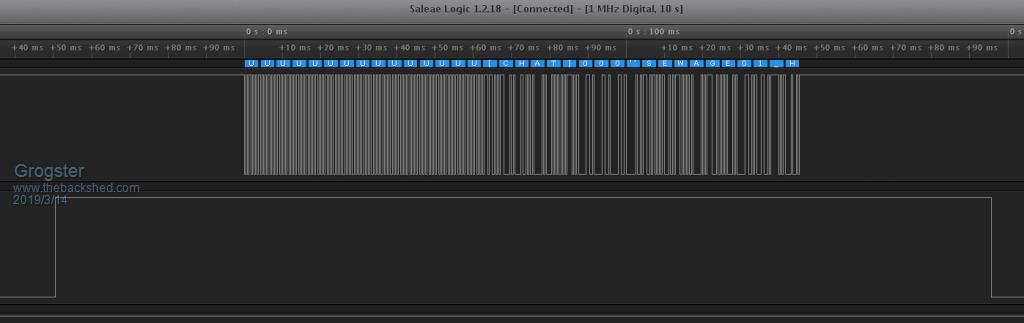

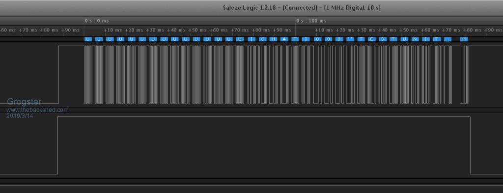

I decided to capture BOTH the PICAXE based unit, and the new Micromite unit data output on my logic analyser to see if it could help me solve the problem:
PICAXE DATA OUTPUT:
MICROMITE DATA OUTPUT:(CSub on pin-7 of an Explore-28 module)
Channel-1 of the capture is the data output.
Channel-2 of the capture is the ENABLE line to the NTX2 module.
On the Micromite version, I have extended the ENABLE out from 5ms to 100ms, so that I can hear the burble on my scanner radio. The data is most definitely being transmitted, but the PICAXE based receiver only gives me corrupted data - which is odd, as the baud-rate is the same, both use the same number of preamble 'U' bytes, and both use the ENABLE line.

The PICAXE seems to introduce about 4-5ms of delay between the message and the last byte(the mode byte), which can be either 'H' or 'R'. I thought perhaps the Micromite - being much faster then the PICAXE - might be streaming data too fast for the PICAXE to process it at the other end, so I introduced a 5ms delay between sending the payload and the mode byte, but it made no difference at all.
The reason I did this, was that in the PICAXE-based transmitter node, there is a 4-5ms delay between the payload and the mode byte. This is NOT by design, it is due to the time required for the PICAXE to decide what mode byte to send along with the payload.

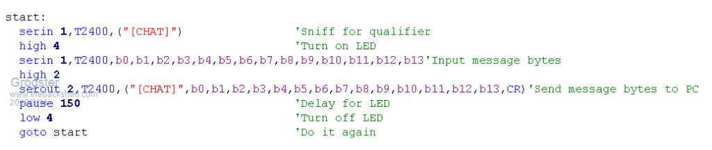

The PICAXE code for the receiver is:
EXTREMELY simple, but does NOT work with the same message - at the same baud-rate, sent via a MM chip - but it DOES work 100% of the time if a PICAXE chip sends the exact same message.

When I examined the captured data, I could see that there was a delay of 1.8ms between sending the preamble+qualifier, then another 1.8ms delay between the qualifier and the payload, followed by the biggest delay - about 4-5ms between the payload and the mode byte.
Obviously, the PICAXE is quite specific there, and when you use two PICAXE's - one at each end - there is no problem, as the delays are pretty much the same, so they sync up without issue.
The MM, on the other hand, is much faster and just sends all the data at once, and the PICAXE at the receiver end can't keep up, and a few bits are missed on some of the data packet, and so you end up with corrupted data.(at the receiving end)
So, what I did, was introduce 2ms delays between the preamble and qualifier, and another 2ms between the end of the qualifier and the payload, then a final 5ms between the payload and the mode byte.
The PICAXE receiver now decodes the message 100% correct.
