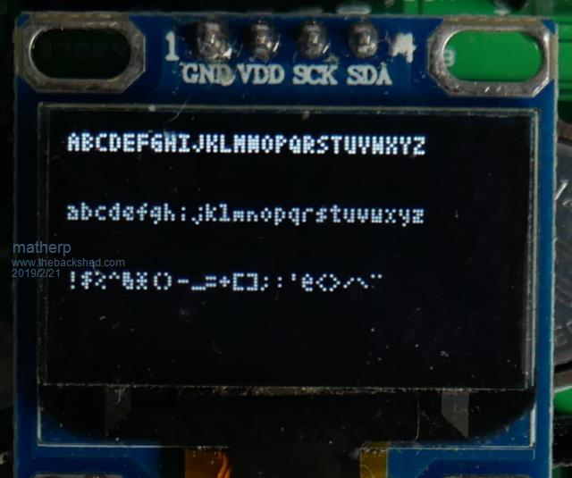

Posted: 08:58am 21 Feb 2019
with thanks to the originator

Holy cow that's small, however, strangely readable like a dot matrix printer font. Nice...

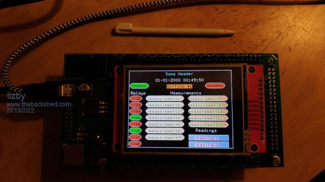

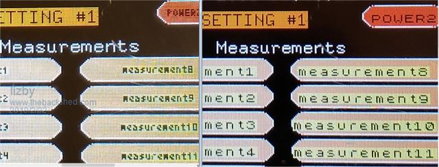

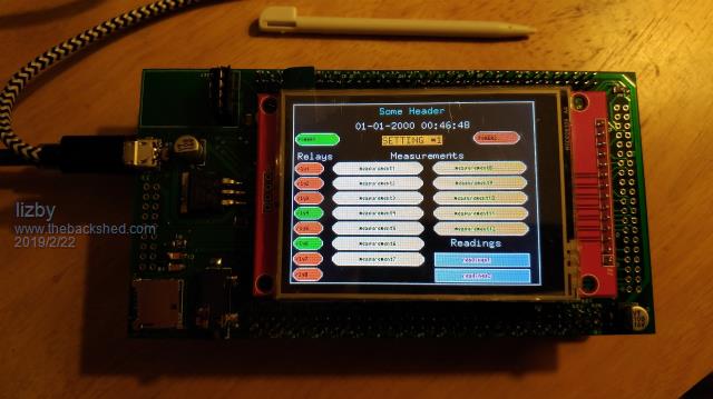

Just because I had a 2.4" ILI9341 handy on an h7-144 backpack, here is this font on that display:
and with the Sinclair_S 8x8 font (from http://rinkydinkelectronics.com):
Compared:
The Sinclair_S font:

The display layout was designed for the Sinclair_S font--this layout is just used for comparison because it was handy.
Edited by lizby 2019-02-23
Posts: 3370
Posted: 05:55am 22 Feb 2019
You would need VERY small fingers to use that screen.

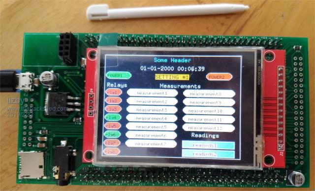

  Quote  The display layout was designed for the Sinclair_S font--this layout is just used for comparison because it was handy.
Try FONT 7 on the H7 or the loadable font below (same thing). 6x8 and much nicer than the square font. The rinkydinkelectronics fonts are all limited by being n*8 wide but Geoff's code in the Micromite only limits them such that h*w is divisible by 8

Posts: 3885
Posted: 04:11pm 22 Feb 2019
  matherp said  Try FONT 7 on the H7 or the loadable font below
Thanks. That's a nice-looking font:
  Geoffg said  You would need VERY small fingers to use that screen.
Stylus only, shown above screen (though nothing actually interactive on this screen). No fingers need be applied.

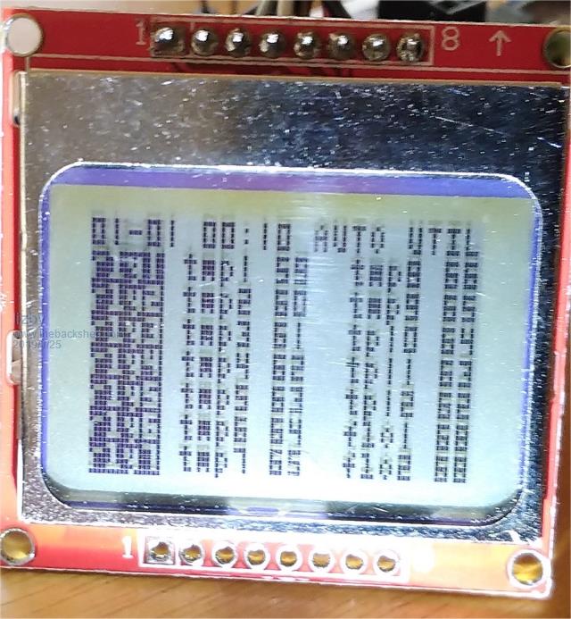

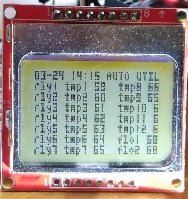

Here is a Nokia 5110 lcd with the tiny font (font 3 in the L4 distro for the N5110):
The screen shot in the original post of this thread has the letters inverted. How do you do this with the TEXT command with a monochrome font?

Posts: 12083
Posted: 07:37pm 24 Mar 2019
  Quote  The screen shot in the original post of this thread has the letters inverted. How do you do this with the TEXT command with a monochrome font?
New section from the manual:
  Quote  Monochrome displays
Monochrome displays can have two "colours" zero and not-zero. All displays default such that zero is the natural colour of the display. In the case an OLED this is not-lit. (i.e. black) and non-zero will be the lit colour (normally white, blue, or yellow for OLEDs). In the case of a Nokia 5110 display, zero is the backlight colour and non-zero is black.
All monochrome displays can be used inverted by clearing the display to non-zero e.g. "CLS 1" and then setting 0 as the foreground colour in any graphics commands. The only issue with this is that displays typically have non-functional borders which will remain the native "zero" colour so graphics or text that touches the outside of the active area will merge into the border.
All monochrome displays have a memory based frame-buffer which is created when the display is initialised. This will have a small impact on the amount of available RAM for program use (RAM used is width-in-pixels * height-in-pixels / 8 + 256 bytes). Using a frame-buffer gives two significant advantages:
1. Monochrome displays can be powered down to save power and then when power is returned the command “GUI RESET LCDPANEL” will not only re-initialise the display hardware but also restore the display contents
2. Updates to the display can be suspended by issuing the command “OPTION AUTOREFRESH OFF”. In this mode drawing and text commands update the framebuffer but not the display. Issuing the command “REFRESH” will write the contents of the framebuffer to the display. This allows complex updates to be made without obvious screen writes being visible. The area written is the smallest rectangle containing all the changes since the last “REFRESH” command”.

Thanks. That might seem to imply that 0,1 as foreground and background in the TEXT command would inverse the monochrome text, and indeed it does:
This produces the inverted text in the first column:
for i=1 to 7 : text 0,i*j,"rly"+str$(i),,,,0,1 : next i
Leaving out ",,,,0,1" results in normal black on white.
