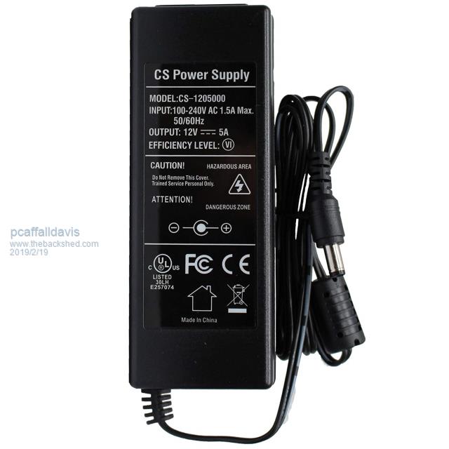

I guess I should specify what I mean by computer type desktop power supplies. I mean the type that often come with laptop and tablet computers; like the one in the photo below. So how do I make sure I don't get more noisy ones with lots of EMF interference when I order a new 12 V 5 amp and a new 24 V 5 amp unit? Is there a better type power supply than switch-mode? Or is it just trial and error? How do I tell if the one in the picture is switch-mode?

Any power supply that specifies an input range of 100 to 240 v ac is undoubtedly a switcher. You probably need an old fashioned stepdown transformer, a full wave diode rectifier, a capacative input filter, a linear regulator, and a final capacative filter. It will be more expensive and a lot heavier. You might save a little if you build your own.

So are all switched power supplies EMF noisy? Are some worse than others? Is there a way to tell, other than trial and error? What kind of 12 volt power supply would I search for, say on Amazon, that is not a switcher?
Clearly my 24 V for the PTZ camera worked and slowly got noisier until it finally failed. Is that normal behavior for a switcher?
I'm not looking for several expensive bench power supplies. Is there some more moderately priced type I should be looking at? Or will I just be better off trying a few different low priced switcher types hit or miss until I find one or two that don't seem to give off too much EMF?

Trial and error is one common way of finding a good one. Price can be a guide but not always.
They usually go bad when the capacitors in them start to dry out.
I use lots of clip on noise suppressors, both on the AC supply side and the DC output side. That helps confine the noise to the power supply. They should be placed as close as possible to the power supply.
I have also put them inside metal boxes with suppressors on the leads where they enter the box,but beware of overheating. That only hastens the capacitors drying out.
