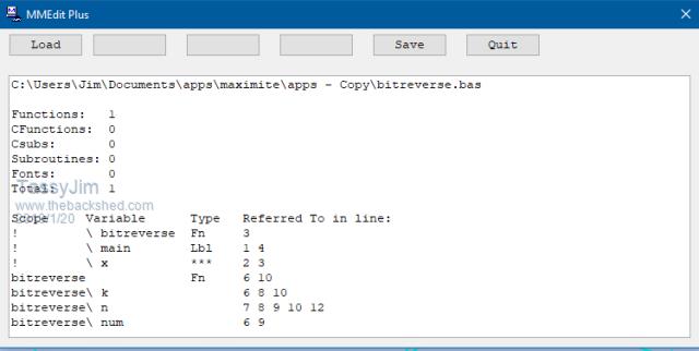

MMEditPLus is a stand-alone variable report producer.
It will eventually replace the one built-in to MMEdit but for now it can be used with Notepad++
It does differentiate between variables local to functions and should flag any undeclared variables.
To run from Notepad++
Go to Run/Run
Navigate to MMEditPLus.exe and add "$(FULL_CURRENT_PATH)"
after the end of the file name. Include a space and the quotes.
Your shortcuts.xml file should now have an entry similar to:
<Command name="Variable Report" Ctrl="no" Alt="yes" Shift="no" Key="119">C:\apps\PBprojects\variableReport\MMEditPlus.exe & quot;$(FULL_CURRENT_PATH)& quot;</Command>
I had to put a space before 'quot' in the above to stop the forum interpreting it.
I set alt-F8 as the shortcut key.
To send the current file to the variable report,
Save then Alt-F8
MMEditPlus can be open or shutdown. It will replace any existing report with one for the current file.
I haven't found a way to automate the save before run part (yet)
If you drag and drop a filename, drop it in the area above the text frame.
You can drop selected text directly into the text frame and it will be scanned.
With MMEditPlus open, ctrl_A to highlight all the text in Notepad++ or MMEdit and drag it across to MMEditPLus.
This allows you to check code without saving first.
  Quote  main:
INPUT x
PRINT bitreverse(x, 16)
GOTO main
FUNCTION bitreverse(num, k)
LOCAL n
FOR n = 1 TO k
IF (num AND 2^(n-1)) > 0 THEN
bitreverse =bitreverse+
2^(k-n)
ENDIF
NEXT n
END FUNCTION

Noticed that the subroutines come up as "Fn" in the "Type" column in the program I'm testing at the moment
Brian

Posts: 6632
Posted: 05:43am 20 Jan 2019
I didn't differentiate between subs and functions.
I also didn't differentiate between const and dim.
For the exercise of tracking variables, the differences don't matter.
