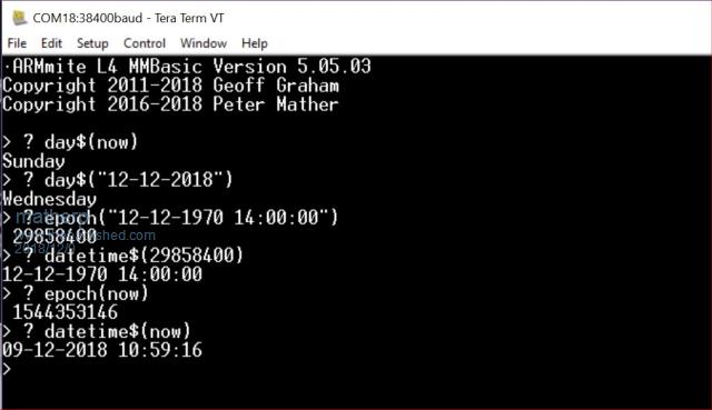

In addition it includes 2 new functions copied from the Armmite L4 which make date and time arithmetic much easier
DATETIME$(n)
Returns the date and time corresponding to the epoch number n (number of seconds that have elapsed since midnight GMT on January 1, 1970). The format of the returned string is “dd-mm-yyyy hh:mm:ss”. Use the text NOW to get the current datetime string, i.e. ? DATETIME$(NOW)
EPOCH(DATETIME$)
Returns the the epoch number (number of seconds that have elapsed since midnight GMT on January 1, 1970) for the supplied DATETIME$ string. The format for DATETIME$ is “dd-mm-yyyy hh:mm:ss”. Use NOW to get the epoch number for the current date and time, i.e. ? EPOCH(NOW)
and example of use to, for example, wait until midnight (00:00 tomorrow) irrespective of month and year changes and without needing any sort of calendar would be:
n%=EPOCH(NOW)+86400 'get an epoch number for a time we know is tomorrow
t$=left$(datetime$(n%),11)+"00:00:00" 'create a time string for midnight
m%=EPOCH(t$) 'calculate the epoch number for midnight
do
loop while EPOCH(NOW) <= m% 'loop until we are at or past midnight

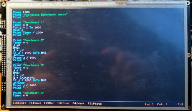

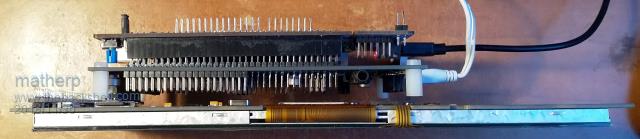

Just received my 9" ssd1963 display interfaced using Grogster's PCB
still got the screen protector on but WOW!!!
Option lcdpanel ssd1963_8_16,l
Edited by matherp 2018-12-01

My thoughts exactly when I first fired mine up, that old saying (sort of) once you go big you will never go back.
Only one problem is using the Camera with the backpack, I'm hoping that adding a short lead won't be a problem.
There is just one slight problem with the SD cards and the 9" LCD. I've tried a few and all work 98% of the time but occasional I get an SD card error, I have 2 other Armmite-H7s running with 7" screens and external SD card readers and they are perfect in every way.
I tried the Backpack SD slot and the 9" LCD slot and both are the same, however I have the LCD SD pins plugged into the LCD Adaptor board, I'm going to remove them in case it's the parallel connection and resulting lead length / capacitance causing a slight problem with the BackPack SD slot.
Thanks again for the fabulous work.

Minor update that allows the EPOCH function to be used for dates before 2000 and changes the format of the day$ function as per the Pi-cromite and Armmite L4 to allow the date to be specified. EPOCH and DATETIME$ now work back to 1902 with epoch going negative before 1970.
