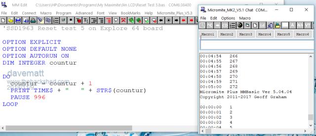

Hi all, I have 2 MM Plus mites running 5.04.09 running a counting program that reliably goes for 5 mins exactly and then restarts itself. Problem is, it's not supposed to! Can post the code, but truly, it's nothing but increment a counter and print.
Mites are freshly flashed, can see nothing to imply some sort of timeout. Can anyone help?

Hopefully this shows both code and result...
Thanks Jim and Grogster. Above is using 5.04.04. I cant find 5.04.08 in the archive, is it available somewhere else?

I have test run your code on my early style E64 module (without the 1455 USB interface). I did 2 runs - first used an external Microbridge (1455) module to interface the serial console pins to the PC USB cable, the second used the USB cable connected directly to the USB socket on the E64 module. Both cases used an external 5v PSU. Both tests ran over 7 minutes without any hint of a restart and I'm sure they would have just continued running if I hadn't stopped them!
My E64 is running firmware version 5.04.08 and my PC is running Window 10 ver 1803.
