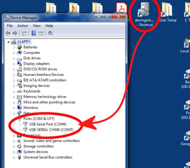

I know the game well, but I look under "Ports" in Device Manager. I have it open all the time (because of the idiosyncrasies of this game).

... which is why I have a shortcut to the DeviceManager on my desktop. This also shows the device type of the port which helps determine which is which
