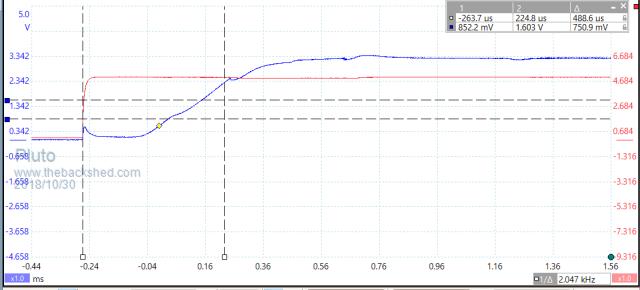

I have the same problem with 64 pin uMite. (Firmware: Micromite_Plus_V5.04.09.hex).
When I first started up, I used a CP2102 USB to TTL adapter to connect to the computer (Windows 10). Everything worked perfectly. I decided then to try powering from USB. Windows does not recognize uMite.
However, if the uMite is externally powered before the USB is connected, then Windows correctly identifies the uMite.
When connecting only USB there is a delay of approx. 500 us between (sharp) rise of +5V and (slow) rise of 3.3V supply to a level of 3.0V. Can it be that the PIC is not happy with first having it's USB block powered before the rest of the chip is getting sufficient power to start?
In my connection the 3.3V regulator is MCP1700-3302E/TO with 10uF on both input and output. Smaller capacitors would decrese the delay, but what would be an acceptable delay between +5V and 3.3V rise?
If my "theory" is correct, are there any firmware possibilities for keeping PIC's USB block waiting a bit before it connects to Windows?
Pluto
Joined: 09/06/2017
Location: Finland
Posts: 421
Posted: 10:40am 30 Oct 2018
In addition to my earlier post.
Blue trace: 3.3V powerline for PIC
Red trace: USB powerline
time scale in ms.
Vertical cursors: 1) Connecting USB, 2) PIC's power at 2.3V (min operation voltage for PIC). 488.6 us before we have 2.3V.

Posted: 11:42am 30 Oct 2018
Pluto
I am interested in your recording 'device' can you give some details about your recorder?
Pluto
Joined: 09/06/2017
Location: Finland
Posts: 421
Posted: 01:13pm 30 Oct 2018
It is a PICOSCOPE 3224. 2 channel 10MHz oscilloscope. USB connected. Useful also for decoding I2C and SPI.
