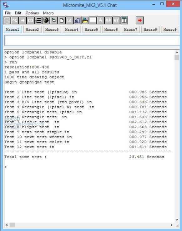

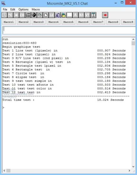

my test for armite with stm32h7
option lcdpanel ssd1963_5_16,rl

  Quote  my test for armite with stm32h7
Try
option lcdpanel ssd1963_5_BUFF,rl
This writes to a buffer first and then modified areas of the buffer are output to the screen. Some tests may be faster, others slower. The advantage comes when as a user you control when the write comes using OPTION AUTOREFRESH OFF/ON and the REFRESH command. Set OPTION AUTOREFRESH OFF and then run the tests. In this case only the buffer is updated, nothing on the screen unless you put a REFRESH command at the end of each test.Edited by matherp 2018-08-26

Posted: 07:36am 25 Aug 2018
it is more slow in rectangles
i have no tested loading image
goc30
Joined: 12/04/2017
Posts: 435
Posted: 07:45am 25 Aug 2018
for loading image, option "buffer" is realy marvelous
very good job
