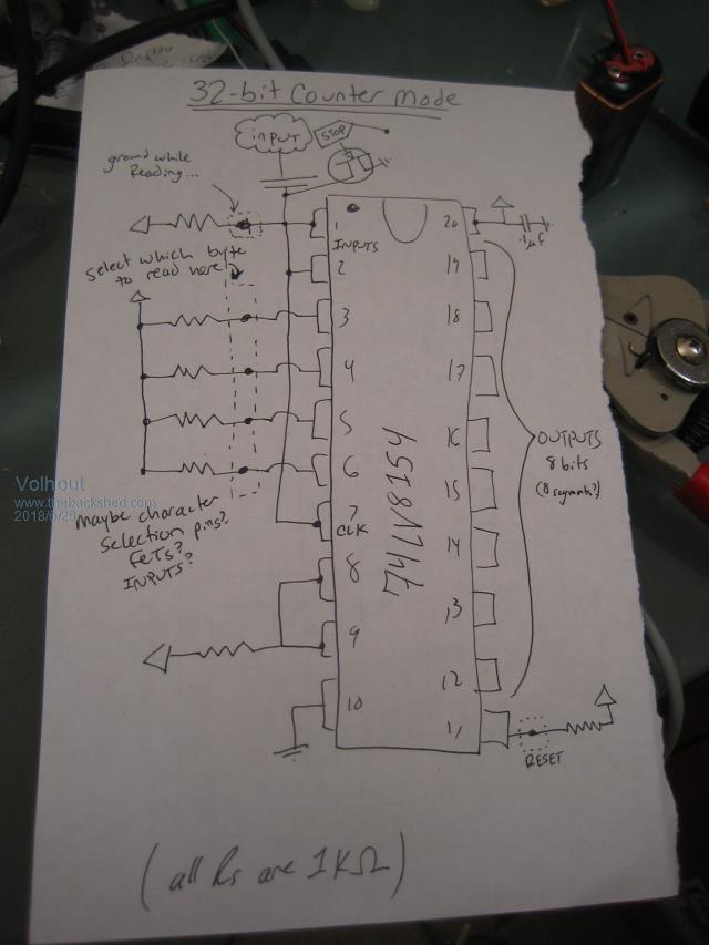

A simple solution is to use the SN74LV8154-EP
It has 2 internal 16 bit counters that can be chained to a 32 bit counter.
The output is 8 bit parallel with 4 select inputs. So you can read out all 32 bits in 4 bytes.
You only need to provide an accurate count gate (i.e. a 1msec pulse) and clear the counter before opening the count gate.
The frequency guaranteed over the wide temp range (-55...+125C) is 25Mhz, so I expect if you keep it at room temperature, it will work fine for 27MHz. It is 3.3V in so you may want to add a small amplifier before it to easily tap into oscillator circuits.
Good luck building....

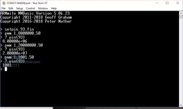

The latest version of the Armmite code includes support for a high speed frequency counter.
Using SETPIN 93,FIN or SETPIN 93,CIN, pin 93 (PG8) is configured to clock a timer as suggested in the posts above. The timer then generates an interrupt on timer-overflow (16-bits) allowing total counts up to 2^63 before counter overflow (normal Micromite integer).
I've tested the functionality up to 20MHz which is the fastest the PWM on the Armmite will run and it seems to work perfectly.
The concept could be engineered into the firmware of the MM+ and/or MMX but the PIC has far fewer timers than the STM32 so it may compromise other functionality. There is no chance of doing it on the MM2Edited by matherp 2018-07-12
