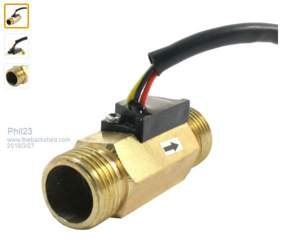

I've been using these ones for the past couple of years in the Spa & Heat Pump Controllers.
Seem to be remaining stable with no issues yet.
Did notice though that they are available in Stainless now.
Phil.

Phil23
Joined: 27/03/2016
Posts: 1667
Posted: 09:32pm 27 Nov 2018
  Andrew_G said  I'm looking at these 1/2" flow meters which I think are the same as Phil23's above.
They look absolutely identical to mine.
Dunno how long they have been installed now, but it's been a few years with no issues. Bromine & now lithium chlorinated water running thru them.
My code is totally primitive, just reading frequency periodically.
Flow rate is my requirement, not an actual volume measurement.
[code]Sub ReadFlow
FlowRate=Pin(FlowSen1)/424*60
End Sub
[/code]
The easiest lines were added to get things going, so might be a good time to pinch Choppers's superior code.....
Cheers.

Phil23
Joined: 27/03/2016
Posts: 1667
Posted: 09:14pm 28 Nov 2018
I hot mine from Aliexpress & as mentioned they were also available in stainless.
The 424 is corrected l/h; 8.1x60=486; but when I ran measurement tests it was a bit off.
This is the only data I had.
[Code]3/4" DN20 flow rate2-45L/min water Brass Hall Turbine flow sensor meter switch control water liquid rate
Product item no. : Ada-B0.75-5
Material : Brass
Brand : Ada
Specification :
Function : Sensor , flow rate control
Thread size : Male 3/4”
Color : Golden color
Flow rate : 2~45L/min
Flow Pulse: F(Hz)=(8.1Q)-3 +/-10% Q=L/min
Max. Working Current : 10mA (DC5 V)
Min. Working Voltage: DC 4.5V
Working Voltage:DC 5V~24V
Load Capacity: =10 mA (DC 5 V)
Operating Working Temperature :
-25 Degree centigrade to +8 Degree centigrade
Liquid Temperature: +80
Accuracy : + - 10%
Wire : Black : "-"
Red: "+"
Yellow : "pulse output signal"
[/code]
Flow sensor
Phil.
Edit:- Weird formula; 8.1x flow rate MINUS 3?
Edited by Phil23 2018-11-30
