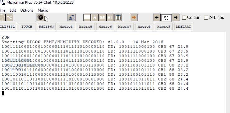

After a bit of inspiration from an idea from @tassiejim on here I have managed to decode the signal on a micromite using a 433mhz receiver.
  Quote   '------------------------------------------------------------------------------'
' Micromite Decoding of DIGOO Remote temperature sensor from Bangood- '
' Author: Gerry Allardice
' Credits: Tassie Jim for initial decoding code '
dim ProgTitle$ = "DIGOO TEMP/HUMIDITY DECODER" '
dim ProgVer$ = "v1.0.0" '
dim ProgDate$ = "14-Mar-2018" '
' The DIGOO remote sensor sends code to the console station via 433.92MHz ASK code.
' It can be decoded by using a 433.92 reciever connected to a digital pin eg(16).
' The code seems to take this format.
' bits 1-13 are unique ID for the unit.
' bit 14 indicates that the message was sent using the test button
' bits 15-16 used to identify the channel selected on the remote. CH1-CH3.
' bits 17-28 contain the temperature. if bit 17 is 0 is a positve temperature and value is divided by 10
' If bit 17 is 1 then is a negative temperature and twos compliment is used and divided by 10.
' bits 30-36 are the percentage humidity
' Inspection of the recieved shows the signal is repeated three times and
' a 1 is about 4ms low pulse. 0 is about 2ms low pulse. stop is about 8ms low pulse.

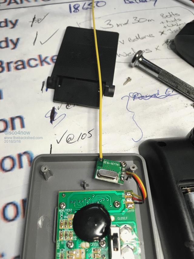

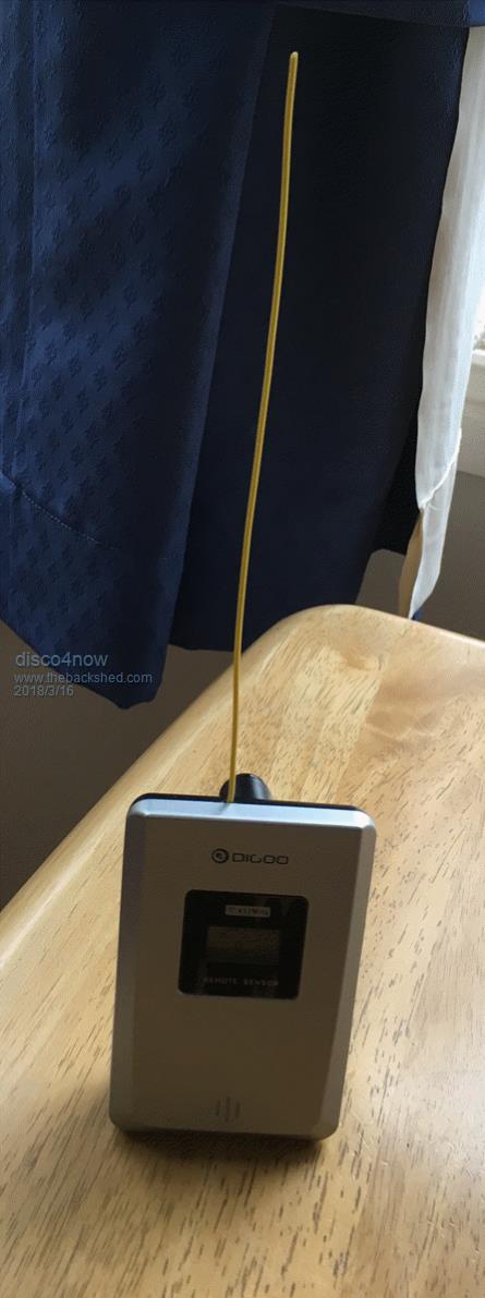

I have managed to improve the reception range so these remote sensors may be useful with the micromite.

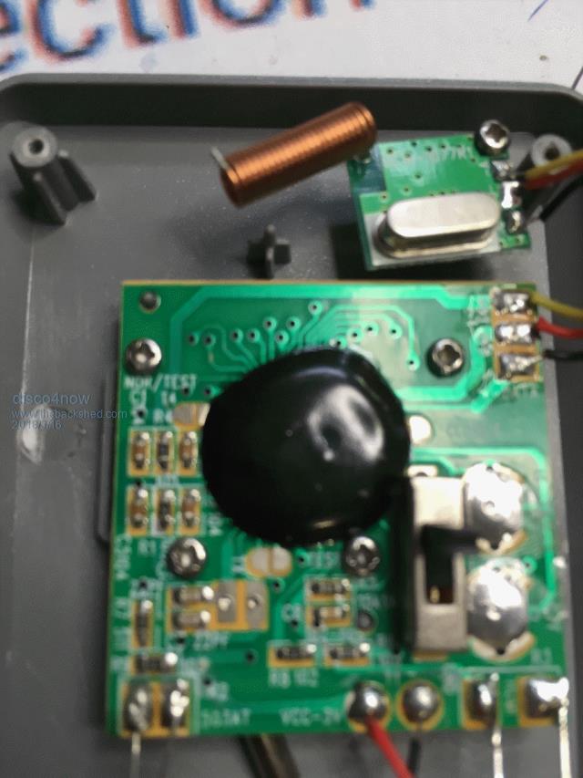

I removed the coil antenna on the receiver and replaced with 17cm wire. This gave some improvement.
I opened up one of the remote sensors and the transmitter is a separate unit near the top.
It is easy to remove the coil antenna and add a straight 17cm wire.
This set up greatly improves the range. I am receiving from a couple of rooms away and one from outside, so getting to the useful range.

thanks for sharing your code! I received my 433mhz receiver yesterday - it works really nice with your code and my 3 DIGGOO remote sensors!
(How) did you modified your receiver? (...where is the antenna on this little thing? - I ordered it from your link)

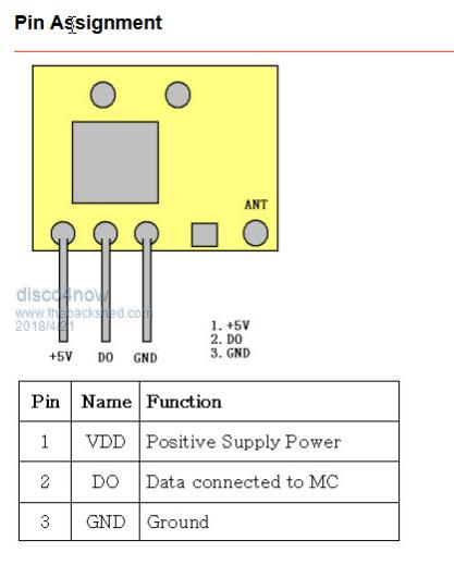

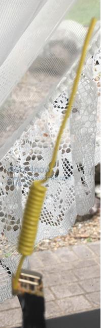

Here is a diagram showing where the antenna is connected.
Found it here.
I am using this loaded antenna from here. A straight 17.3cm wire also seems to work.
Loaded Antenna
