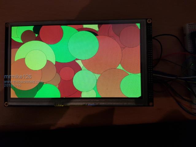

I have been using the ILI9341 displays with my explore 64 with great success. I thought i'd go for it and order a nice 7" SSD1963 display to play with, after a bit of fiddling I got it to work but... the colour is not working correctly (Picture attached), there is too much red. I ordered a second display (as I will need 2 in the end anyway) and this one does exactly the same.

There is no blue in that photo.
Try this at the command prompt:
CLS
TEXT 100,100,"HELLO WORLD!",L,1,3,RGB(BLUE)
If the screen clears but you DON'T see the message, that will confirm you have a loss of blue issue. Which would be odd, as the colours are commanded via the parallel bus, and that is obviously working or you would get nothing - not even that demo in your photo.
I would immediately suspect the LCD, but you say you tried another one and it is exactly the same, which suggests it is something else again.
DOUBLE-CHECK ALL your wiring to the LCD from the E64. You only need one wire in the wrong place for odd things to happen.

The symptoms suggest to me that the screen is in the wrong mode: either 16-bit parallel mode rather than 8-bit, or RGB565 rather than RGB888. Control commands on the SSD1963 are all 8-bit so the display will initialise properly and addressing will work regardless.
I would be suspicious of wiring (possibly DB6). Check not only your wiring to the display but also that you can waggle each of the data pins on the explore64 individually (without affecting any other) and that there are no shorts or open connections at the PIC chip.Edited by matherp 2018-02-17

Id agree Grogster, there is no blue at all. when I try your suggested code this is displayed as a dark red. I have checked and double checked my connections. I have turned each pin on the data bus on and off manually and checked with a multimeter at the header pins of the display and each one goes Hi & Low as expected.
