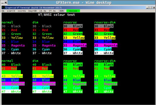

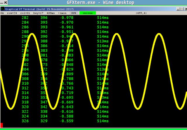

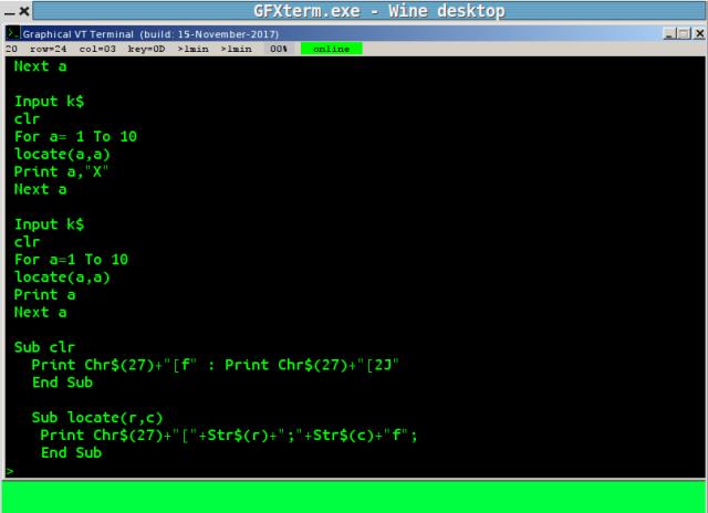

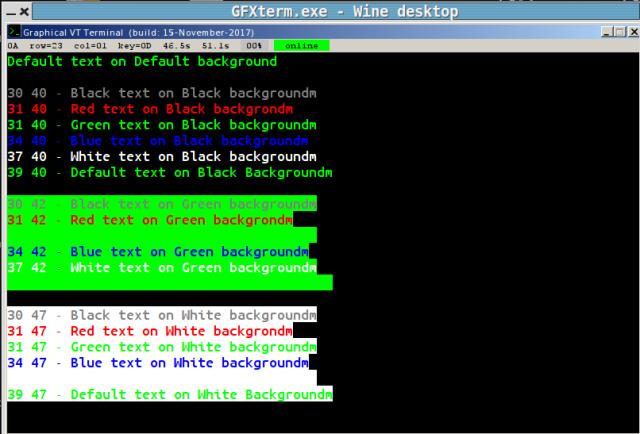

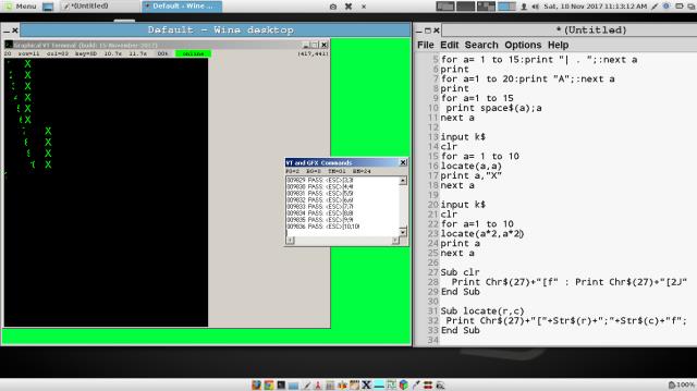

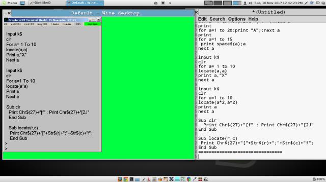

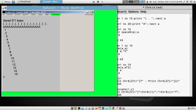

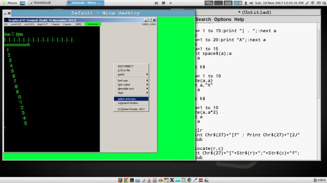

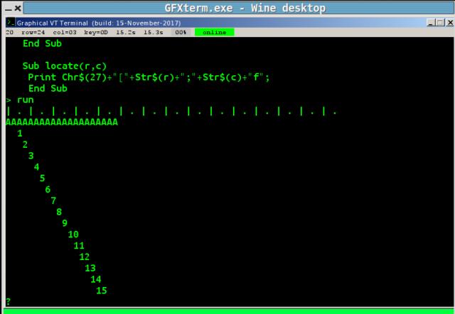

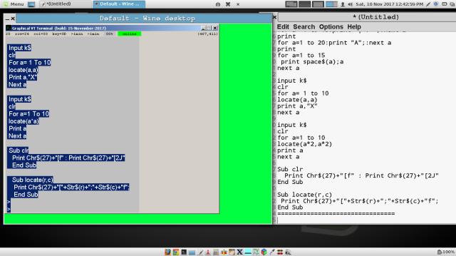

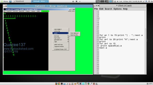

Here is a few screen shots that may help you in showing me
what will need to be worked out.
Hope this helps point to what is going on under wine.

aha, it looks like wine and/or linux is doing font substitution. GFXterm requires two fonts to display the terminal window correctly:
"Terminal" at [9, 12, 14] point in [regular, bold, underline].
"Courier New" at 8 point, in regular.
these fonts are both monospaced (ie, every character is the same width), whereas the terminal window font in your screenshots has variable-width (the letter 'i' is narrower than the letter "m").
the best solution is to ensure that "Terminal" is present and correctly mapped. next best solution is to map in "Courier New" or "Courier" as a substitute, or at least some other monospaced font.
i'll look into how "Terminal" (or an open-source alternative) can be bound into the GFXterm.exe executable.

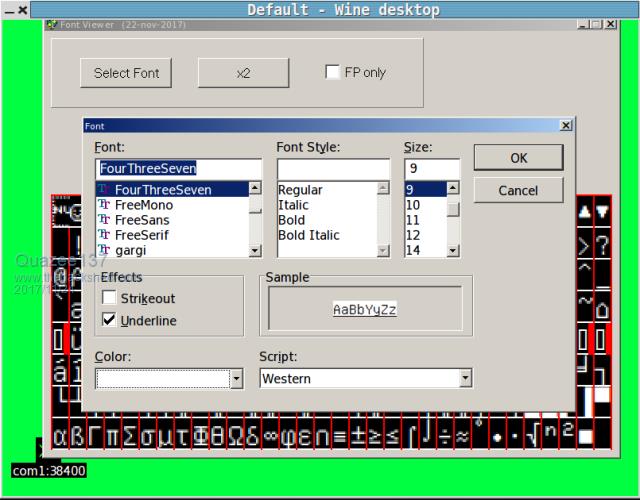

Here is a sample of mono fonts on my system
2017-11-20_070557_Font_Samples.pdf

below is a small utility i whipped up for testing the fonts on your system, displaying the full 256 characters as GFXterm would display them, except with red lines around the edges. to be useful none of the characters in a font should extend over the red grid:
2017-11-22_002136_font_viewer.zip

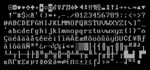

I opened up the image of the character set and had
a bit of a laugh as I had seen that long long ago.
Code page 437

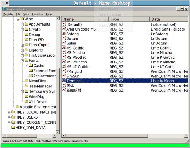

Posted: 10:26am 23 Nov 2017
Rob found a way to use a replacement font for the Terminal font.
Registry Keys
I did it a bit different in the replacement font part
I found a Japanese font I didn't need and changed the name to
Terminal and them Modified the data to Ubuntu Mono.
Quazee137Edited by Quazee137 2017-11-24

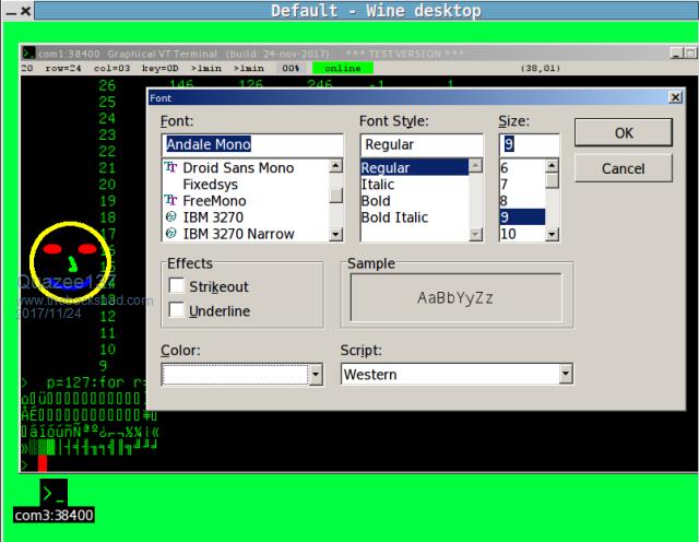

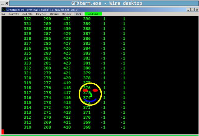

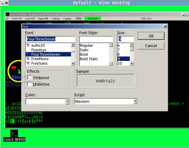

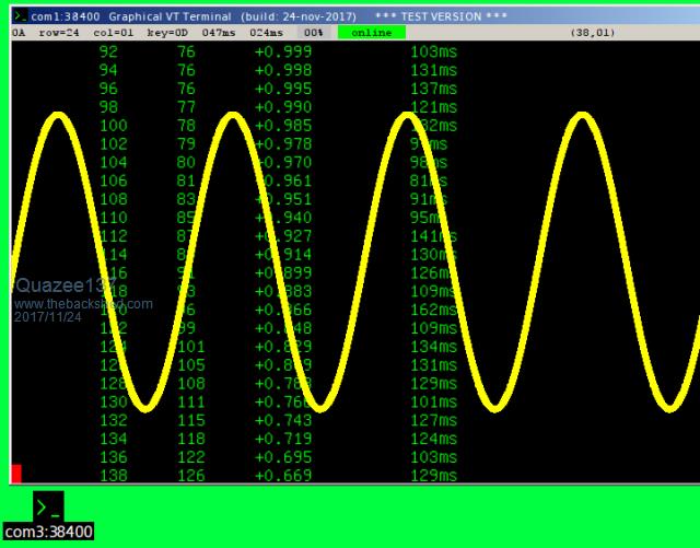

Posted: 12:09pm 24 Nov 2017

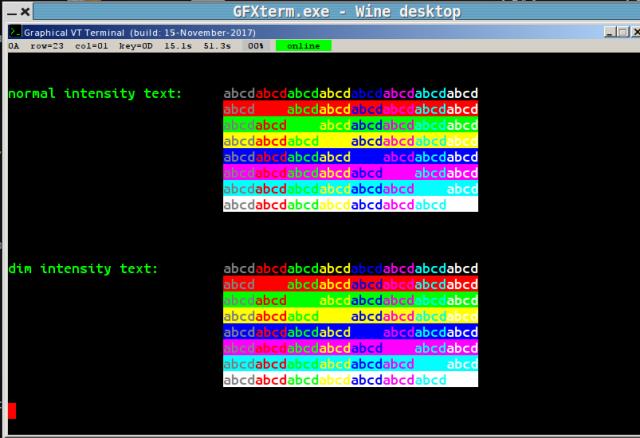

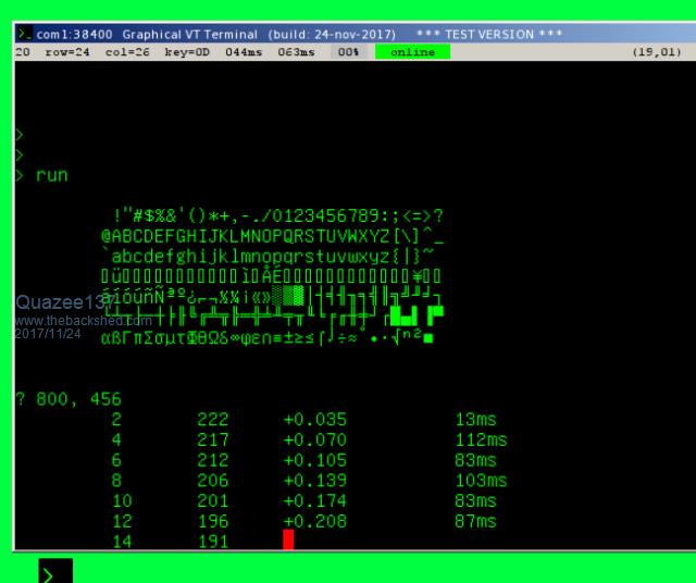

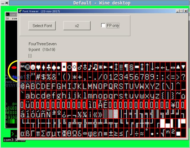

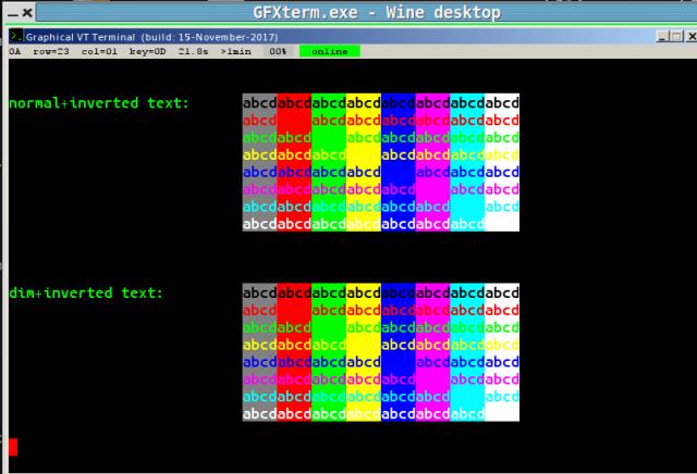

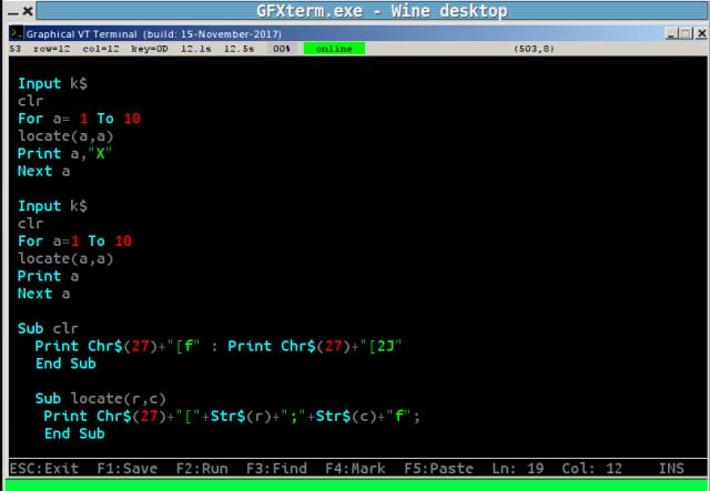

Here is a few screen shots of the test code.
The font viewer check box FP when checked didnt see
the font and GFXtern didn't see it.
So I did the font replace in the reg and it works.
Where does GFXterm test look for the fonts?
I added it to my Linux fonts and to the wine fonts.
And heres the font thats working.2017-11-24_222151_fourthreeseven-master.zip
Edited by Quazee137 2017-11-25

the test version only showed monospaced fonts - my mistake. here is a slightly changed version (one byte different!) that should now show all fonts available to windows:
2017-11-24_232038_GFXterm_TESTB.zip
GFXterm doesn't 'look for the fonts' as such in any specific place, all these test versions do is ask windows to pop up a font selector dialog - the dialog itself with the list of fonts is entirely generated by windows. when you click on 'ok' the dialog closes and returns to GFXterm the details of the font you selected: name, size, character set (script).
the name + size + charset are then set in the font field of various visual objects (the text layer is an object, as is the cursor, and so is the 'select and copy' view). when GFXterm tells one of these objects to print or display something the font information for the object is passed to windows to do the actual printing.
does this make any sense? it is kind of an odd way of thinking about things that is hard to get one's head around. the bottom line is that GFXterm has rather limited control over what is going on!
an extra complication is that if you select a font that windows thinks is unsuitable, then it will quietly substitute another font. but there seems to be no way to tell when windows has done this, or what other font is substituted in, it is all quite invisible to the application.
addendum: the "FP only" checkbox sets a flag that tells the font selector dialog to only show monospaced fonts. i think that by definition truetype fonts are not classed as monospaced.

more progress, resulting in another test release, this one now saves the font selection between runs:
2017-11-27_215106_GFXterm_TESTC.zip
i've found a good FREE font to use is "DejaVu Sans Mono", available here:
https://dejavu-fonts.github.io/
i've been testing with 14 point, giving a screen size of 880 x 528 pixels (11x22 pixels per character).
as before, hold down shift while right-clicking to bring up the menu. select font size -> manual, select the font, but now enter either "0" or "-0" for the font width to try to automatically calculate the cell size. "-0" is preferable, as it also forces the character set to OEM. once a manual font selection has been made, the 'manual' menu option will continue to be available until one of the 9/12/14pt menu options are made.
proportional fonts are now handled by centering them in the cell and filling the whole cell area with the background colour before printing the character on the screen.
grogster and quazee137: are you able to give this a good exercising in both windows and linux? if there are no bugs it will become the next release in the other GFXterm thread.

Rob,
Under Linux with WINE the wider chars overwrite the one(s) to left/right. (Maybe they're all doing it but it's only obvious then.)
Oh - I tried 12pt & 14pt and both did it.
No need to hold shift when right-clicking to choose the font.
JohnEdited by JohnS 2017-11-28

john: that is right, under wine the characters overlap. this is because normally GFXterm is hard-coded to use a monospaced font called "Terminal" that is included with all versions of windows. linux generally lacks this font, and wine (rather recklessly) goes and silently substitutes a proportional font that produces the mess you observe.
this is why i've added a feature especially for linux users: holding down shift while right-clicking to bring up the menu unlocks an extra menu option 'font size -> manual'. this option will allow the linux/wine user to select an alternative (monospaced) font to use in place of the hard-coded "Terminal" at 9/12/14pt. the extra menu option then remains unlocked until 9/12/14pt "Terminal" is selected.
i'd envisage very few linux users wanting to use GFXterm, as linux already has many fine terminal emulators. hence the use of a normally hidden menu item to provide a fix for those few who need/want it.

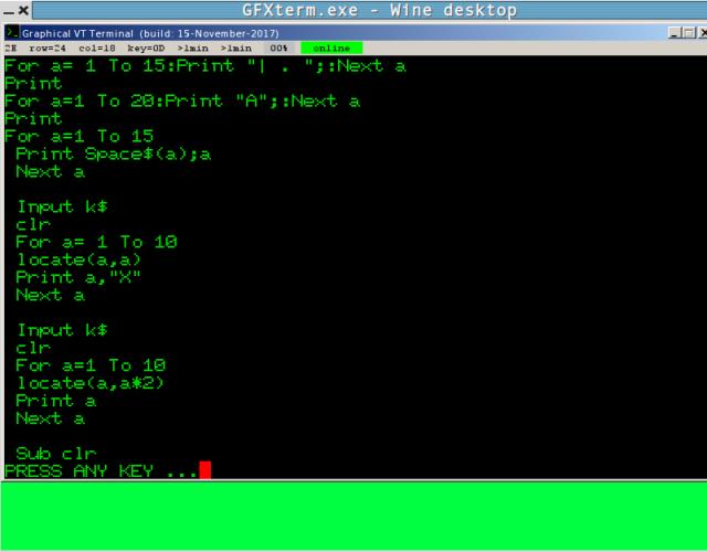

Posted: 11:12pm 28 Nov 2017
Rob the DejaVuSansMono works.
Are you going to use the DejaVuSansMono in place of the Terminal font so
it just works, no need to edit the wine reg?
Even with all the other terminal packages for linux this makes for very
easy buffer paste code testing. No xmodem or setting up ASCII transfer
timmings as in a few other terminal packages. I like the buffer paste
for sending the OPTIONS to a Micromite. I have five sets in a file and
can just copy and paste the one I need. Lazy me! This does save on typing.
