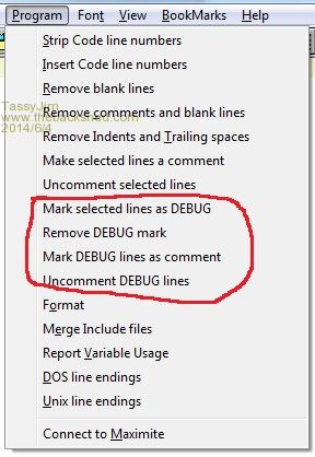

I have been thinking about the DEBUG code.
If we end the DEBUG lines with a comment
for n = 1 to 5 'DEBUG
print stuff(n) 'DEBUG
next n 'DEBUG
It would be easy to convert those lines to a comment (and back again) for the full program.
'for n = 1 to 5 'DEBUG
'print stuff(n) 'DEBUG
'next n 'DEBUG
The process would be something like:
Highlight the lines,
MMEdit adds the 'DEBUG
option to convert all (or selected) to comments and back again
You then have the option to crunch....
This wouldn't break any existing code and saves on typing etc.

Posts: 6626
Posted: 12:49pm 04 Jun 2014
Very close Peter.
I spent a bit of time playing around with various options yesterday and there is a bit more playing to do.
The first stage will not be a toggle.
Highlight/Select a set of line(s)
Click Mark Debug button
MMEDIT appends 'Debug to the selected lines.
or
Click Remove Debug button
remove 'Debug
Lines which are already a comment for the full line are left alone.
If there is a comment starting at the end of the line, the Debug options work as normal.
You can then 'select all' and 'Mark DEBUG as comment'
MMedit scans source and prepends ' to every line which ends with 'Debug
There will be something to play with later.
