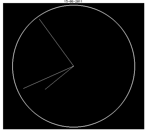

Posted: 09:43pm 14 Jun 2011
Here's a screen dump of the analog clock programme which I'm porting to the maximite.
Bob Devries
Dalby, QLD, Australia
