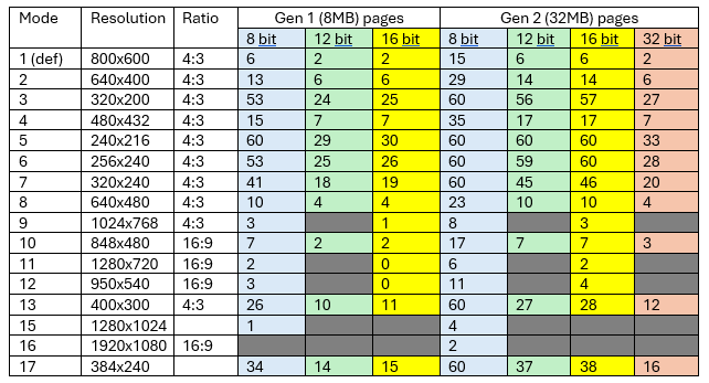

Indeed. If/when I get the CMM2 talking to my industrial touch-monitor (RS232), these high-res/colour modes open-up some possibilities:
