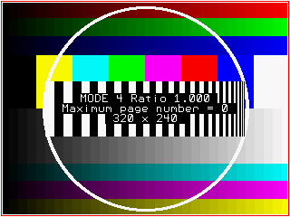

This is a modification of a test card program I wrote for the cMM@ a few years ago,
It should run on a picoVGA as well as picoHDMI bit I have only tested on the HDMI.
Widescreen mode is OK.

On VGA (with hardware color palette) it will look completely different.
The greyscale is not a scale. RP2350 and RP2040 are the same on VGA.

  Quote  TassyJim,
I have flashed Version 6.00.00RC3 PicoMiteRP2350HDMI in the RPI2 and I am working with the Olimex board. Operation via Tera Term which is also displayed on an HDMI screen. Further OPTION RESET OLIMEX selected.
Played around with your test image program. I have 1 HDMI monitor and a TV with HDMI.
I have to manually set my HDMI monitor to 4:3 mode to get a round circle. The TV automatically switches to 4:3 mode because others do not provide support, but automatically a nice circle.
Arrow Up = Space. All screens work correctly in 4:3 mode and mode 1 to 5 work correctly and no distorted image.
+ and - option doesn't work yet or I don't understand?
Saving a .bmp file also works well, but is a bit large.
Jan.
Replied here to keep the firmware thread clear.
If your circles are not round, use + and - to stretch/shrink the circle until it looks right. Then, in your programs the circle command has a parameter for aspect ratio:
  Quote  The optional 'a' is a floating point number which will define the
aspect ratio. If the aspect is not specified the default is 1.0 which gives a
standard circle.
The size of the BMP files is due to the number of pixels for each resolution.
BMP is the only format available.
