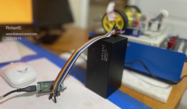

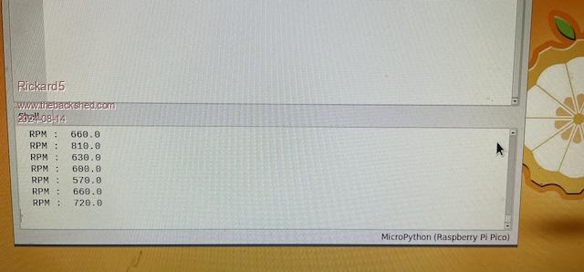

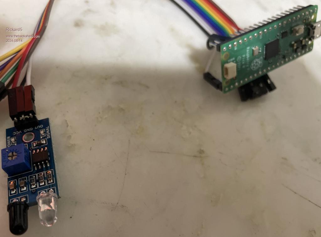

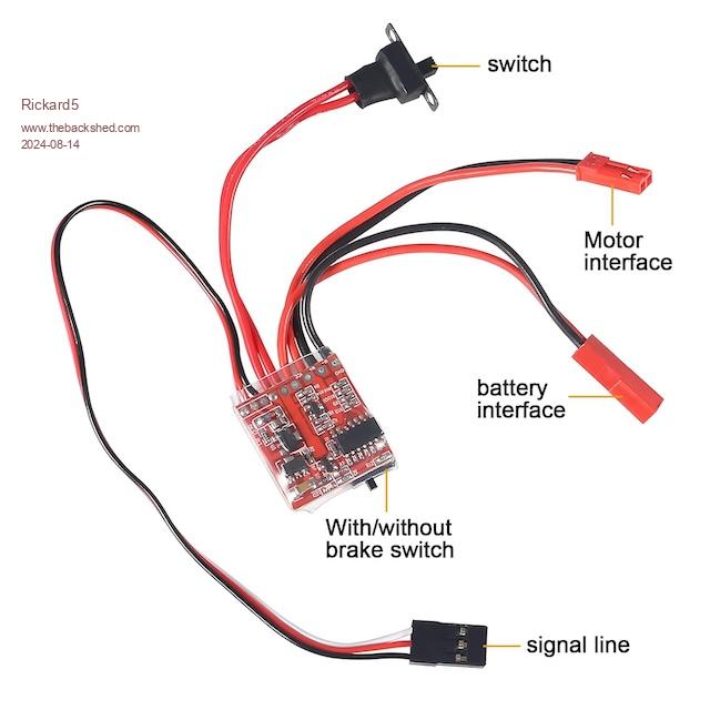

After much Research on Google and Youtube I found a Pico Tachometer that will do the job, best part is it's in Python so I'm going to have a go at porting it to MMBasic :). I also bought some RC Speed Controllers , They will work just like any servo PWM signal, so Part 2
will be taking the Feedback from the Tachometer and developing the Logic to control the sped of the motor

you may find that the IR detector simply does not work.
That was my experience of them, not
too much crosstalk between RX and Tx, swamped the signal.
suggested solution is a wodge of Bluetack between Rx and TX
Try swapping 2 and 3 over

That simple type work well inside an enclosure but in the open are affected by ambient light level and confused by 120Hz flicker from mains lighting.
An IR remote receiver has a wide range AGC and a narrow 38kHz filter to eliminate these problems.
Though @DaveJacko,s comment is also relevant, best performance is when there is no direct 38kHz IR from the LED to the receiver.

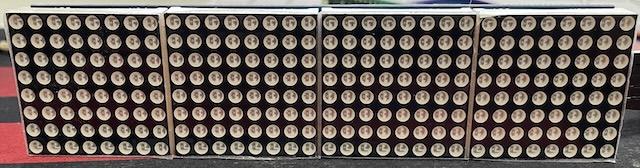

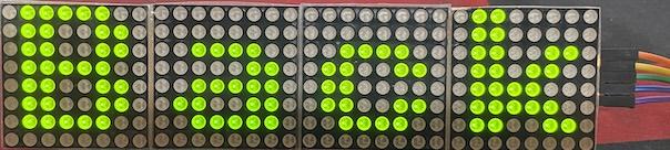

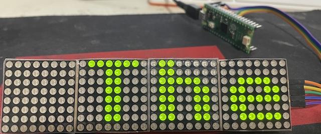

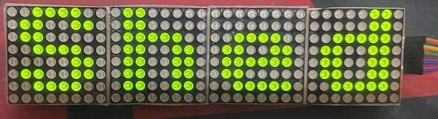

I ALSO MADE MADE ANOTHER THING TODAY TO GO WITH THE TACHOMETER, I HAVE A BUNCH OF THESE max7218 LED grids, I figured hoe to use them in Python as Displays ! they are DAISY chain able so I can use 1 fro each Axis and Spindle speed and only use one SPI, if I format the output right :)

I kinda figured I'm gonna have to Machine a Shaft encoder Wheel and use an I/R Pair out of a Mouse and you guys have Made KNOW IT !I'm going to Print a Light cover for the Spindle end, and tomorrow I'm gonna run over to a Buddy's shop and use his big Lathe and mill to make a an encoder Wheel

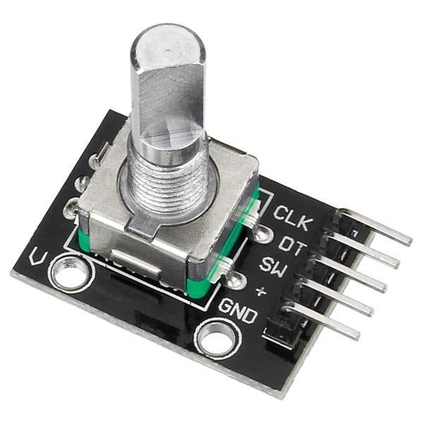

@ PhenixRising That looks like a cool encoder Cheap I found a Data Sheet here and it Max's out at 5k rpm. So cutting 1/2" Brass @ 760 SFM will give us an RPM of 5810, so I'd have to Gear drive that down 4:1, But I do like that I'm thing of getting a couple they look a LOT more Robust then the Crappy Ones you get from the local Scumbags like Adafruit and Bang good like these:
PhenixRising
Joined: 07/11/2023
Posts: 2100
Posted: 01:21am 16 Aug 2024
When it comes to the best possible velocity control, it's all about resolution. The more the better. Gear it down if you like but there's always a huge safety margin on these devices.
The neat thing is that; the PicoMite can keep count of this stuff no sweat, using the PIO counters.
Yeah, the type you show is for panel-mount but the one from AE is intended for machinery-type applications.
