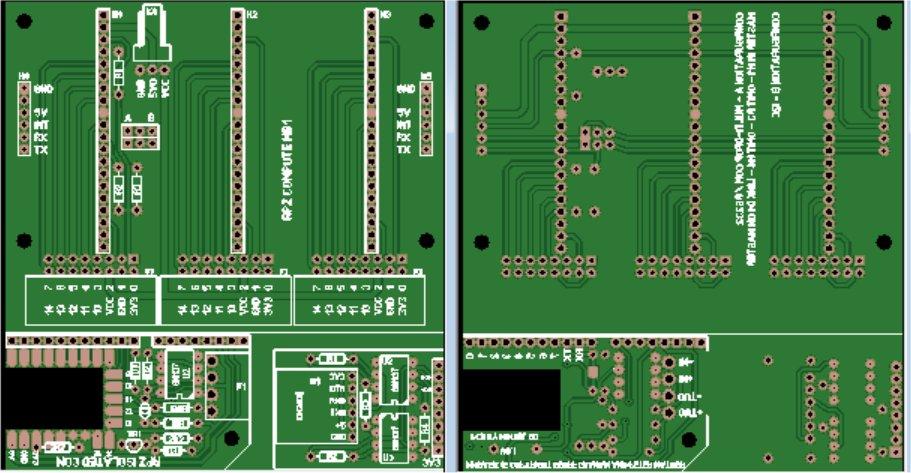

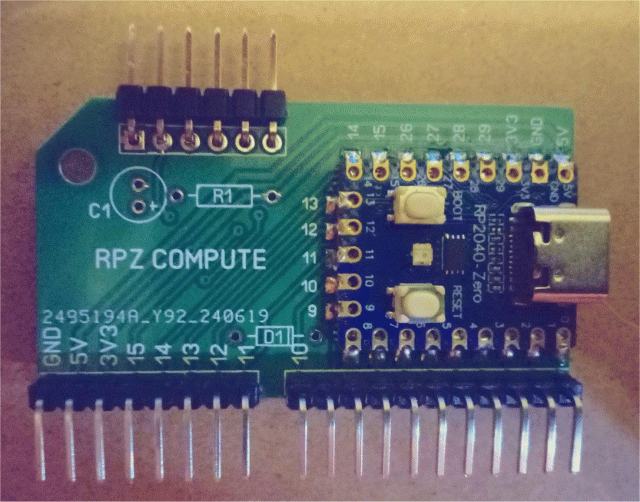

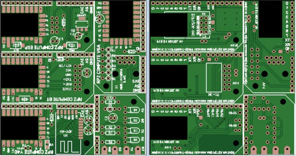

  Rickard5 said  I'm looking at building it modularly with 1 Master Pico that is the User Interface, and modules for Speed control and Stepper
You mean you basically want Mick's RPZ system with additional modules (if actually needed)?
Mick's RPZ Compute

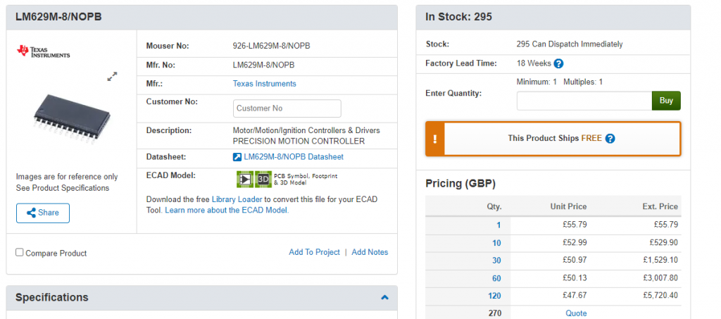

It can't be overstated, just how great the PicoMite has become for proper motion control, thanks to the PIO.
A very common dedicated motion chip is the LM628/629. The PicoMite blows it out of the water....look at what it costs:
The MMBasic code is ridiculously simple and I can provide all that you need.
