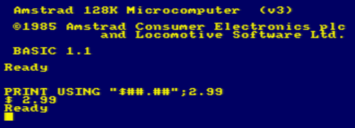

  Mixtel90 said  ... PRINT USING ... has rarely, if ever, appeared in ROM versions ...
<pedant mode>
It was supported in Locomotive basic which was ROM based on the 3rd most popular 8bit machines of the middle 80s. Milions of the buggers.
Here's proof
</pedant mode>
your point about it being a  CPU hog is well made.

I didn't know Locomotive BASIC had it. Trust Alan Michael Sugar Trading to be b*** awkward...   ;)
PRINT FORMAT$(2.99,"%0 10 g" to you too. :)
