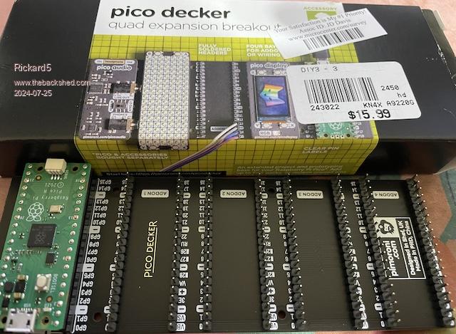

is there any Chance of making either of the Pimoroni Demo Bases work with Picomite the DV Version here  Or the VGA Version ? I started Acquiring the Parts to Build myself a Pico BBC Micro , and should have just bought a Vintage BBC Micro! Dang that PiMoRoni and that whole VAT thing! But it would be cool if we could use a USB to Serial like in the BBC Micro Video for Keyboard or used the onboard USB because the Pimoroni board provides power! Plus what I really want More than it all is to have one of those boards and replace the pico socket with a ZIF Socket so I can just swap picos to change from BBC to Picomite to Commodore 64 to apple //e to Speccy etc...

I'm real excited about the pico Decker and the idea of maybe having some 9 slot clones made for robotic Projects, and masking everything like VGA/Keyboard an expansion card with the same form factor of a pico maybe doing a sensor interface card and a motor driver card etc....
