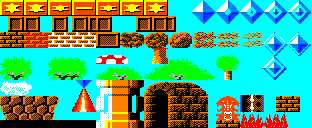

1. Create a Tile Image
   Description: The first step involves creating an image that contains all the tiles you will use in your game.
   Tools Needed: Paint.net (or any similar drawing program).
   Steps:
       Design your tiles, making sure each tile fits within a specific grid (e.g., 24x16 pixels per tile).
       Convert the image to the 16 colors allowed by PicoMite VGA. You can usually do this by reducing the color palette in your drawing program. Some colors that do not exist in this form must be created by dithering.

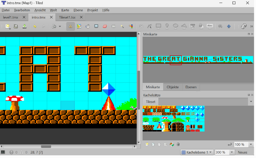

2. Create the Map
   Description: After you have your tile image in the correct color format, you need to assemble these tiles into level maps.
   Tools Needed: TileEd (a tile map editor).
   Steps:
       Open TileEd and load your tile image.
       Use TileEd to arrange your tiles into the desired level maps. This involves placing tiles in the correct positions to create the layout of each level.
       Once you are satisfied with your level maps, export them as CSV files. TileEd will generate a CSV file that lists the tile numbers in the order they appear in your map.
