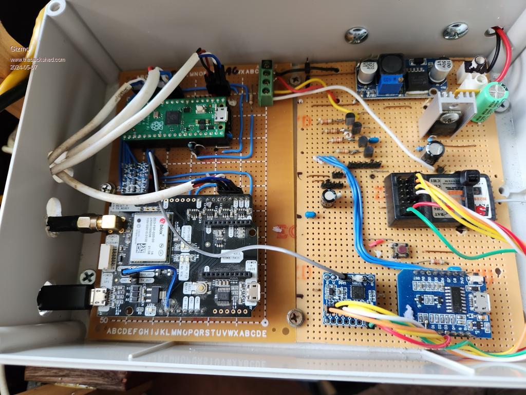

Making progress on using the PicoMite for a rover project. So far its reading compass, distance, RC and GPS data, plus sending the telemetry data.
On com1 I'm getting corrupt data, most of the time. A few CtrC's and RUN's, and its back to normal, but if I stop the program and run it again, its bad data, so I keep trying stops and starts until its good again. The data is at 38.4kb, NMEA data from a GPS module. Its almost as though the com port is starting to read bytes mid byte and getting out of sync. Am I missing something, is there a best practice to reset the com port in a program, clear the buffer if the data is bad?
Code below.

I might try a pull down resistor on the Rx line of the Pico. Its only a short run of a couple inches, and there is a level shifter in there, the GPS is outputting 5v.
I also need to receive data on com2, will try that later, but tis sending data just fine.
I wonder if I issue close and open com port commands in code if the GPS data is bad, might be a solution.

Rather than a level-shifter it may be better to use a voltage divider.
1kΩ between GPS Tx and Pico Rx plus 2.2kΩ from Pico Rx to ⏚.
The Pico digital inputs can tolerate up to 5.0V (the datasheet is conservative) so just the 1kΩ between GPS Tx and Pico Rx should also be ok.

A crude fix, but it works for now. If it receives 5 GPS(VALID)=0 in a row, it closes and reopens the comport. On about the 3rd or 4th com restart it worked and is fine after that.
I'll get rid of the level shifter and go for the resistor divider, I may need that level shifter port for another job.
if GPS(VALID)=0 then BadGPSData=BadGPSData+1
if BadGPSData>5 then
 close GPS
 SetPin GP12, GP13, COM1
 Open "COM1:38400" As GPS
 BadGPSData=0
end if
Hey G, the run from the GPS module to the Pico is only a couple inches. The other devices on the 4 wire cables are all working ok, but if they play up I'll be upgrading the cables. When this mower is 200 meters away from teh base station it will need all the clean signals it can get. 4800bd is way to slow for what I need unfortunately, especially from the GPS module.
