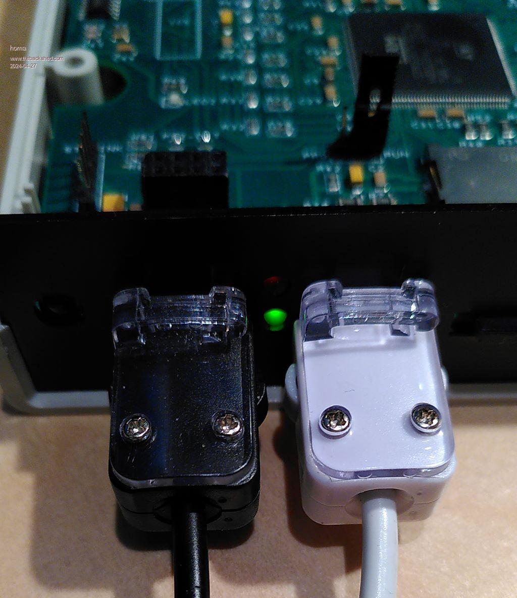

Then I noticed another flaw in the hardware design. You need a tool to get the plugs out of the sockets ;-)

For the two port design the left-hand port is connected to I2C channel 3 and the right-hand one to I2C channel 1. Only the CMM2 Deluxe has a port connected to channel 2.
I believe your mistake is not providing the second parameter in all the calls to the CLASSIC(funct [, channel]) function, if you don't provide a second parameter then it assumes channel 3.
