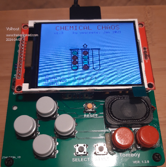

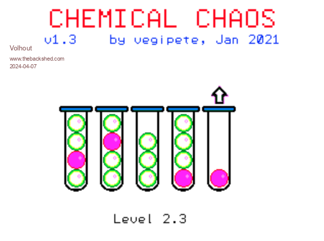

ChemiChaos
In 2021 Vegipete released ChemiChaos for CMM2. It is a game where you move chemical droplets to the right container(vial) to make the lab safe.
At that time I played the game until the last level, spend a whole evening to get that far,
I have ported the game to PicoMiteVGA and Game*Mite. Of coarse adaptations had to be made since the graphics resolution for PicoMite (VGA and ILI9341 LCD used on Game*Mite) is only 320x240 for color. One of the most dramatic is the use of the build in text font. The font in the sprite file was barely readable on LCD screen when scaled to fit the text.
The list of changes:
- I scaled the spites file to 50% in MS-PAINT for LCD
- For VGA I re-painted vials and droplets in 16 colors palette.
- I removed MOUSE from the game, there is no mouse support in PicoMite.
- I added the support for Game*Mite buttons and Menu.bas.
- I centered the vials on screen
- Many, many coordinate changes to fit everything hardcoded to the 320x240 screen.
Quirks:
VegiPete added 2 lines to the mouse cursor sprite file to store keyboard clicks and mouse clicks. I left this in, since somewhere in the future is the addition for a nunchuck, that needs a mouse cursor. Currently the mouse cursor is not used at all.
The software is working on PicoMiteVGA V5.08.00 and Game*Mite V5.08.00. The device specific setting are using MM.DEVICE$ where "PicoMite" is used to select the Game*Mite and "PicoMiteVGA" for the VGA. For other platforms adaptations will be required.
To make use of the 16bit color of the LCD, the game does not make use of framebuffers and sprites. It copies part of the actual screen in memory buffers using BLIT READ and BLIT WRITE. As a side effect the start of the game shortly shows the sprite file.

Tested on Game*Mite.
great realization, fun to play thanks for that

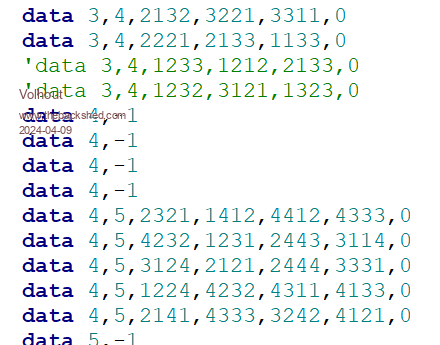

The levels are in data statements at the end of the program, lik this:
The lines that have a "-1" are randomly generated. The other ones are specific for their complexity or cleverness. I guess I would remove some of the random ones. Especially the ones with few vials, since they are not challenging .. too much alike.
P.S. The ones commented out, are so by VegiPete. Maybe he was not sure if they can be solved.

Hi Martin,
Not really.....
The sprite format is limitted to 16 colors.
In the Game*Mite it loads a 24bit BMP into the LCD (Peter converts it to 16bit color), and I read these back into memory buffers. So on the Game*Mite the game runs in 16bit color.
On the VGA it does the same, but then it is converted to 4 bit color (and it has it's own SPRITE BMP that is manually adjusted to give a cleaner picture with only 16 colors). So for the VGA version that is feasible.
