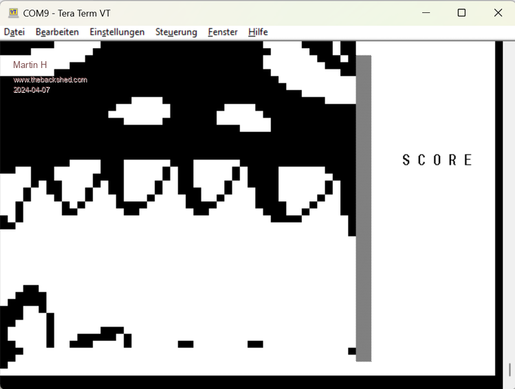

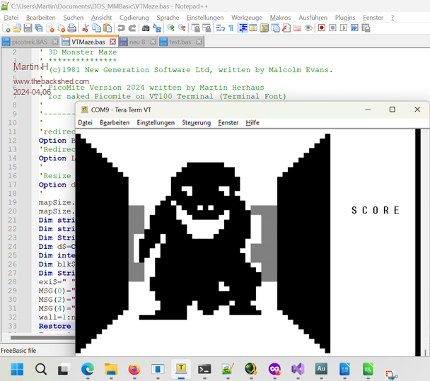

Since I didn't have a Pico with graphical capabilities available for the time over Easter, so only my laptop and a "naked" Raspberry Pico,
I have dealt a little with the possibilities of the display in the terminal window.
Since I've already been asked several times to add the monster to my 3D Maze, I've gone on a search.
I found a well documented source code of the ZX classic 3D Monster Maze and an overview of the game mechanics
So what could be more obvious (or because I like to torture myself) than to try to adapt the game to the VT graphics.
The "TERMINAL" font contains a few graphic symbols.
Since these are very limited, I decided that each character is composed of 2 characters. Some ZXsymbols are still couldn't bee done, but in my opinion you can get over that.
so this is, what i got so far...

3D Monster Maze in Terminal

Next level
Rex now tries to catch you, but doesn't hurt you yet (for debug reasons) ...
So you can (still) simply walk through him.

Intro
Gameplay
Gotyou

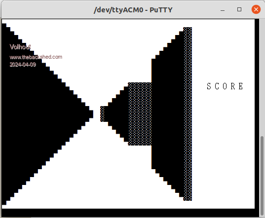

Hi Martin,

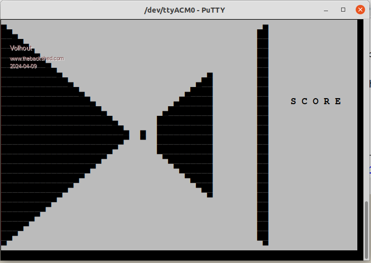

My VT100 screens look like normal ascii characters, not.the block graphics in your screenshots. Putty.

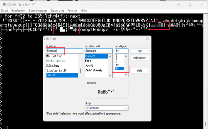

  Volhout said  Hi Martin,
I will try teraterm later today.
Good Morning Harm,
For the correct representation, pay attention that your terminal program uses a font that contains the graphic symbols in the range above 128.
Especially CHR 176-178, 219, 220 and 223 are important here.
I Use a Font called TERMINAL
Martin

Posted: 07:21am 08 Apr 2024
Hi Martin,
On teraterm I selected "Terminal" font, and now it looks the same.
On Putty I have tried several fonts (i.e. Monospace, Ubuntu Mono, Fixed, Courier), but none give the same result as teraterm. The "Mono" fonts do show some graphical characters, but they do not have the contrast (black versus grey). I'll try somemore later today.

Posts: 5995
Posted: 10:23am 08 Apr 2024
Hi Martin,
Teraterm, with font "Terminal" gives the same as the pictures you posted. So it is correct.
Putty with 10+ fonts I tried gives either text, or it gives graphics, but the graphical symbols are different. I.e. the black blocks and the grey blocks all look the same (grey).
I also googled about graphical symbols and putty and vt100, and saw several hints to settings in Putty that could be changed, but neither of them solved the problem (data encoding, translation, etc..). I think it is imply a different implementation of the graphics symbols in these fonts.

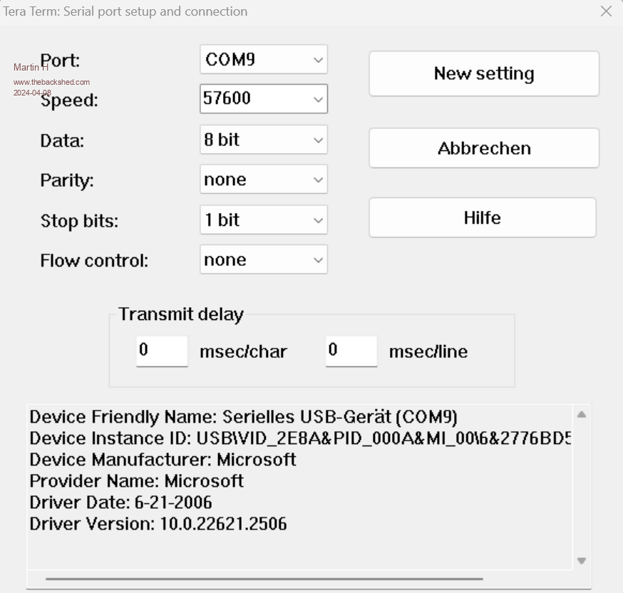

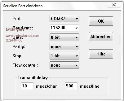

Posted: 10:39am 08 Apr 2024
Hi Martin,
If I remember correctly, in the original the approach of the T-Rex was announced through messages!??
My baud rate is 115200:
You got a private message.

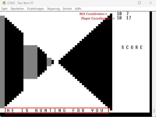

  twofingers said  Hi Martin,
Kind regards
Michael
Michael,
You are right, the messages appear in line 24, i.e. at the bottom of the screen.
These messages are already included in the code, but I have not yet built in a sub-routine do show them.
Here I try to orientate again on the explanation of the original game, when which message should appear.
I also created the Sub for the Maze after this explanation.. and it took me 3 attempts until it worked like it does on the ZX81 (only much faster).

Posted: 03:39pm 08 Apr 2024
Many small changes and I have now added the message display.
Determining the distance works (thank you pythagoras). It is still missing to determine whether he is in a straight line with no Wall Blocks to the player(REX HAS SEEN YOU) and the warnings that he is next to or behind the player.I have also not yet implemented the time-controlled hiding of messages if the status does not change.
But that shouldn't be the problem
I have the coordinates of Rex and the player displayed for checking, but I will remove this in the final version.
VTMaze_wip.zip
Have fun testing
Martin
Yes I know, when you are eaten by Rex he jumps back and forth, this is because his coordinates are the same as yours, so neither bigger nor smaller. This is where the 2nd method comes in, that he looks for a random path if he can't find a direction. But that doesn't matter, because the game is normally over then.

Posts: 4379
Posted: 06:58pm 08 Apr 2024
This works for me:
Ubuntu 23.10 (mantic)
PuTTY 0.78
Window->Fonts->Font used for ordinary text: Courier New
Window->Translation->Remote character set: CP437
Window->Override with UTF-8 if locale say so: unchecked <-- may not be necessary
The only issue is narrow white horizontal lines between each row ... and that PuTTY keeps crapping out, but I think that's just PuTTY.
Posts: 5995
Posted: 07:33pm 08 Apr 2024
Hi Tom,
I think I found the culprit. I am running Ubuntu 20.04 LTS at home. And the latest version of putty for ubuntu 20.04 is 0.73.2
Version 0.73 does not have Courier font. On my work I run 22.04 LTS and that one has Courier font. I will try your proposal tomorrow.
This is what it looks like with the available font (i.e. server.fixed).
But I will experiment a bit more...
EDIT: It is the color setting: Window->Colour: change Default Foreground to 255,255,255
Then select font 8x16, 10x20 or 12x24, these fonts do not show the white lines...
