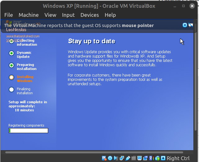

I'm on my way to configuring the VM. XP was the last Windows version I used on my personal computer before moving to Linux.

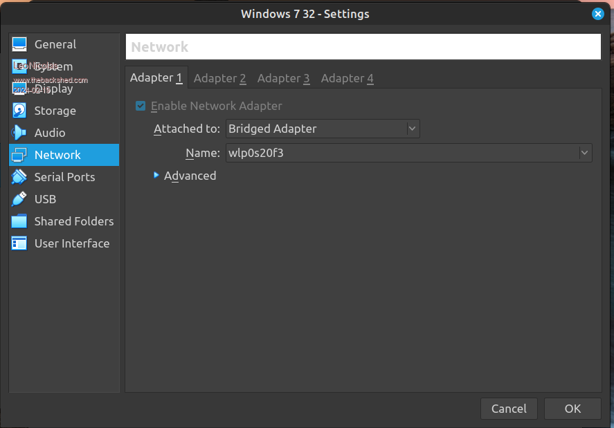

1) After installing the SO in your VM, change the Network configuration from NAT to bridge. This will allow the SO in the VM to see your network.

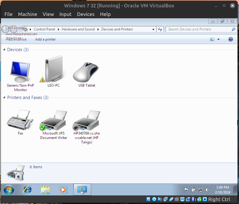

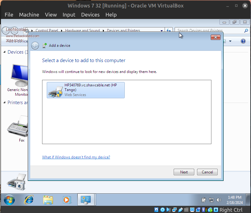

4) After installing Windows 7 (and changing the network to Bridge), W7 could find my network printer without any issues and automatically install its driver.

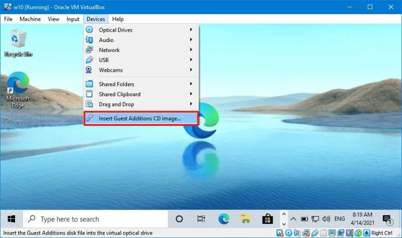

As soon as I inserted the VM Guest Additions ISO into the virtual CD-ROM and ran that(inside the W7 VM), that completed fine, and wanted to reboot - so I let it.

In my tests, I installed the VM Guest Additions ISO from inside the Virtual Box menu. It worked fine.

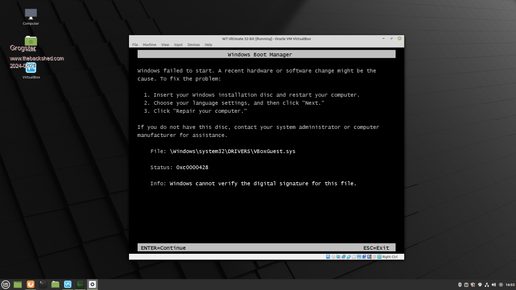

I setup a brand-new copy of W7, and the very first thing I did, was insert that image and run the installer, and even on the completely clean install, it fell over a died and would no longer boot.
This time, I grabbed a screenshot of the error:
Oh, BTW....YES....I ticked "Trust software from Oracle" etc during the setup, so Windoze should not be bleating about this at all.
I wonder if there is a bug in the latest version of the guest additions image?
EDIT: Or perhaps the download of the ISO for the guest additions I have is corrupted or something?  I do remember using the guest additions before years ago when I was last playing with VB, and I don't remember there being any problems.
