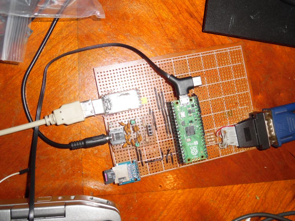

the usb serial to ttl is a male socket and plugging into a usb2male to female lead unreliable.
looking for female usb serial to ttl

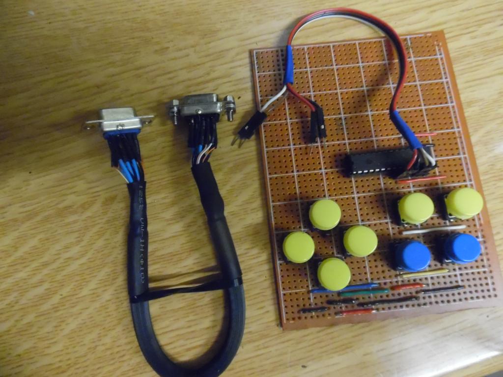

I only got bread board vga pico. solder stripboard tomorrow
got vga sockets and gonna use mcp23017 i2c 16 pin expander for key input.
the usb vga is nice but serial usb to ttl is 5v power and all my connections fail.
thing is do I use a keyboard in a program? no. so why bother with usb ?
gonna do a nice stripboard normal vga tomorrow. got a pack of 5 inductors for sound filter,3 left. veecad handy. I'll be using pico blue usb c. seem ok

the female to male serial usb to ttl is a pain.drops out and tried a few

usb vga pico2... so interesting 2040 stuff on pico2
with usb then 5v from serial ttl to pin 40 5v sys. I stuck it into socket 40 not soldered hence my problems. soldered and stable.. no windows dinky ding dinky dong.

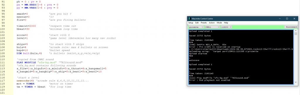

> run
[105] Play modfile "sfx-bg.mod" '"RISsound.mod"
Error : Mod playback not enabled
Dunno what's wrong. I did have sound with 2040. maybe pico2 problem.
Graphics are great. this is pico2 usb vga.. someone's got to test it. regards, stan

Stan, I think you must have forgotten, if you are going to use PLAY MOD then you have always had to preallocate some of the flash to it, e.g. at the prompt:
OPTION MODBUFF ENABLE 192
WARNING! this will erase the contents of A: drive.
Good luck,

This will erase everything in flash including the A: drive - are you sure (Y/N) ?
Error : Could not find the file
> UK USB Keyboard Connected on channel 1
> Generic Gamepad Connected on channel 2
> run
> option list
it was   play modfile "b:\sfx-bg.mod" '"RISsound.mod"
now it plays and sound.. got level 3
