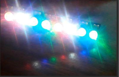

This was a test I ran on a strip of 8 RGBW LED's...
The brightness values are set to "02" (very low) so the phone wouldn't freak out...

This seemed to run OK on the Pico...
I haven't tried the device command yet...
