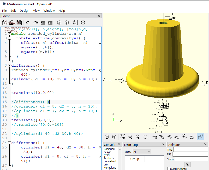

- I can design basic shapes using OpenSCAD (I haven't tried others yet)
- OpenSCAD appears to be not all that intuitive but I reckon I can pick up enough to do what I need (there are strange terms like "hull" that need to be looked up)

This is the mushroom 'work in progress', complete with a flat bottom and hole up the centre.
