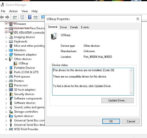

I have just plugged in a USBasb programmer, but Windoze wants drivers for it.
I hoped it would just I.D. as a standard COM port, but aparently not.
Can anyone help me find the drivers I need to make this thing talk?
Thanks muchly.

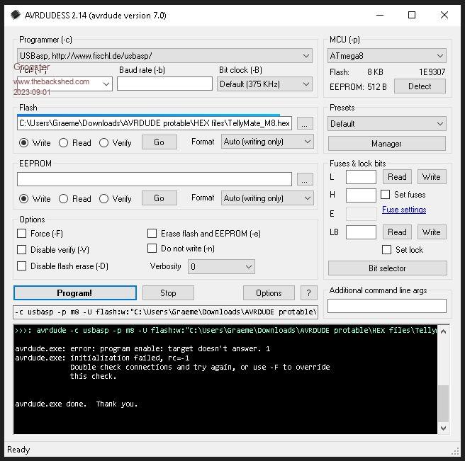

OK, I have installed the driver, and Windoze seems to be able to see it there:
But AVRDUDE does not want to talk to the chip - in this case, a 28-pin MEGA8.
I am totally unfamiliar with Atmel MCU's - do I need to install a 16MHz crystal oscillator on the breadboard?  With PIC's, you don't need to install a resonator or crystal to program them most of the time, but Atmel controllers might be different.
In the case of this MEGA8, I have connected both Vcc(7) and Avcc(20) to the 5v Vcc from the USBasp programmer, both GND pins(8 & 22) to GND, and set the voltage selector jumper to 5v.
I have SCK from the programmer on SCK(19) on the MEGA8.
I have MISO from the programmer on MISO(18) on the MEGA8.
I have MOSI from the programmer on MOSI(17) on the MEGA8.
There is 5v on the power pins of the MEGA8.
This MEGA8 is supposed to be running the TellyMate composite video output program, and it's OSC is a 16MHz crystal.  I think I might need that, so I will install that on the breadboard and try again, but if someone can just confirm for me that Atmel MCU's must have that crystal OSC in place to even program at all, that would be helpful.

Here is the output, when I click on DETECT:
Posts: 6626
Posted: 07:22am 01 Sep 2023
third line
could not find USBasp.
You need that bit fixed before you worry about the MEGA8

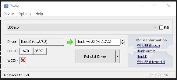

On windows use must use ZADIG and must choose the correct driver - you want libusb-win32. This is not the default - use the dropdown. Suggest you uninstall zadig and start again
Posts: 10072
Posted: 12:01am 02 Sep 2023
@ JIM - VID & PID match.
@ matherp - I did follow the ZADIG program, and did select the win32 driver INITALLY, but when I rerun ZADIG, it says it is trying to use libusb0 driver, so I have selected libusb-win32, and will try again.
This is how I am about to proceed:
Wish me luck!

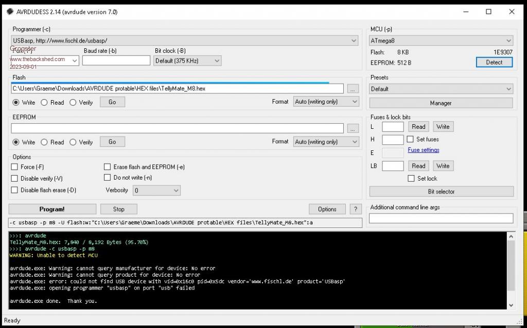

EDIT: Nope.  "Unable to detect MCU".....
However, NOW I am not getting the USBasb error line in AVRDUDE, and besides that I am also now getting a 2nd red blinking LED on the programmer module, when I try to do things, so I think AVRDUDE is happy enough that it can see the programmer now, so I will still take that as progress!!!

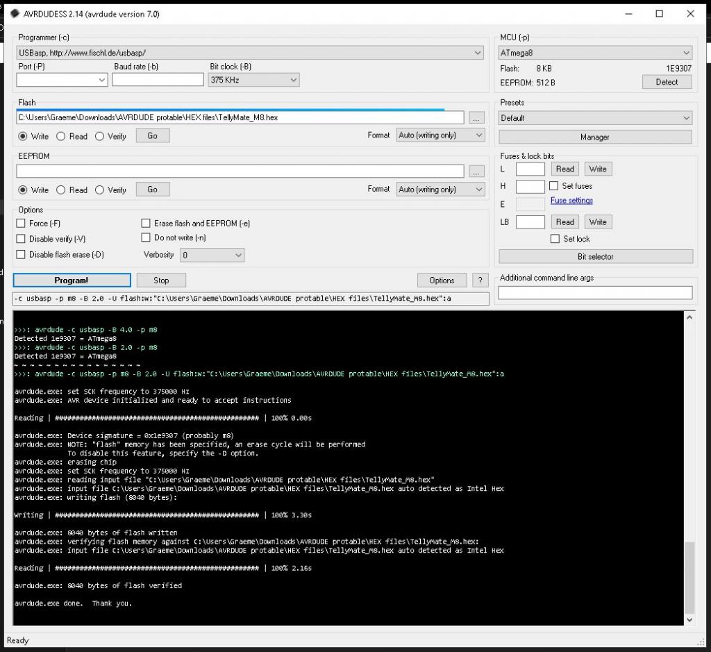

Owwwww - "Detected 1e9307 = Atmega8"....
Lets see if I can program it....
YAY!!!
...and I have discovered that you DO have to have the 16MHz osc in place for the chip to even be detectable at all.  Just tried to do a 2nd mega8 chip without the osc, and no talkie.  Put the crystal and two caps back again, and talkie talkie talkie!
But progress!
I will now program the remaining four chips and store them labelled as programmed with the TellyMate firmware.
