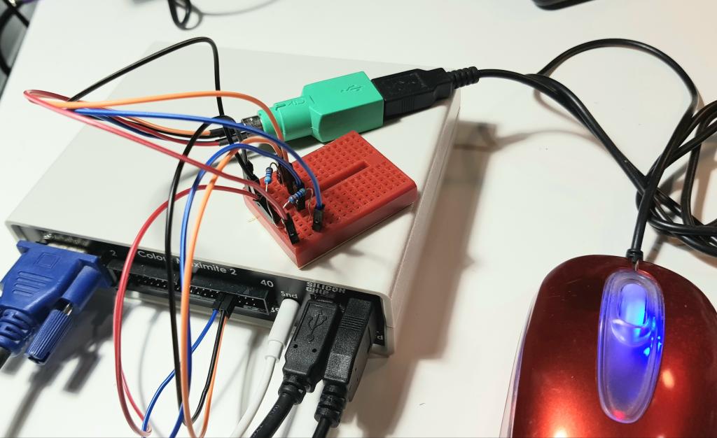

Hi,
 I just completed building CMM2 (Gen 1) from parts supplied by Silicon Chip magazine and Waveshare module. Loaded it with 5.07. I did a burn in test overnight running graphics, sound, games etc for 24 hours.  Its all good and stable.
Later, I connected a PS2 mouse based on the instructions (from the manual) using the required 4.7k Ohm resistors etc. and connected the PS2 pinout to the pins on the back of CMM2 as per instructions. Mouse works 99% of the time. That is, while using it in FILES and EDIT mode, the mouse freezes (along with system) at some rare points. For example, the freeze up happens when I click on the MISC folder in the WELCOME TAPE directory. Each time and everytime. When this happens, the red LED lights up permanently. The only way to continue is to reboot the system.  Also, everyone once in a while when I go into EDIT, I get a "mouse time out" error. This happens intermittently, like 1 in 20 times.
On the other hand, when I run a Basic program (e.g. the fractal demo) that uses a mouse to zoom in and out, the mouse works perfectly.
My guess is (1)  I may have a h/w fault in CMM2 that I may have unknowlingly introduced during my build . Blame it on my poor soldering skills.  Or (2) there may be some undocumented interrupt conflict that I am unaware of, but I am hoping that someone may have already found a solution to this.
Please help.
Andrew

Posted: 01:47pm 26 Aug 2023
Thank you Geoff and Circuit,
   Yes, indeed I suspect it has to do with power load and may have something to do with my temporary setup (as pictured). I have not used a genuine PS2 mouse, but a rather dated USB mouse with an adapter. Yup, I have been hoarding a boxful of old PC parts that I have been hoping would come in handy one day - just like this one, but....
Anyway, I tested nine old USB mouse (all at least 7-8 years old), from which 4 worked with the PS2 adapter and the rest did not. From those that worked, all gave the same similar freezing up problem when used within EDIT and FILES. The freeze up only occurs when it tries to access the SD drive. I have not made any measurements as Geoff and Circuit has suggested for the time being, as I have placed an order for a native PS2 mouse via Amazon. Still waiting for it to be delivered. And if still gives the same problem, I will follow this up by breaking up the CMM2 box and have a proper look inside.
As an aside: I am not sure if the difference between how the USB and PS2 is triggered has to do with the freezing up problem. That is, while the USB signals are polled (round robin), the  PS2 works on actual interrupts. And because I am using an adapter, I am unsure if this is messing up how CMM2 handles the incoming mouse clicks.  This is my 2-cents worth for now.
I will update this post once I have tested it with the new PS2 mouse.
