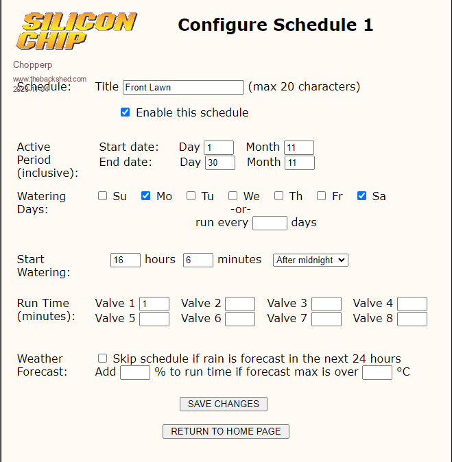

I've just started playing with this on a bare bones 2040 W today.
On setting the watering days, the prescribed timer does not appear to be get set for the current day [Mo] unless [Sa] is selected as well, in fact selecting just [Sa] will set the timer for the set time for today & run at that time. (Set time > than current time). In all other cases, the auto refresh timer gets set to midnight.
Selecting [1] for every day works OK.
Am I missing something? Just wondering.
(Config below only works if [Sa] is selected as well and set time > current time.
Brian

Hi Brian,
I may be wrong (yet again) but the system knows that today is Saturday so it won't run today's schedule on Monday.
Is that it? (if so we can have a good laugh together)

OK.......for some unknown reason, I thought it was Monday. Not feeling too good today. Should be out elsewhere instead of being at home so got confused.
Need to triple check stuff before I post
Laughs on me.
Thanks Andrew.
