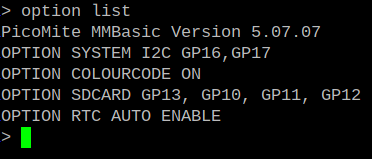

Hi all;
What am I missing about the GOSUB command?
I get this weird error "Error : Invalid character:" when I use GOSUB Test, but if I just use the word test and leave out GOSUB, it executes the subroutine correctly????
I have supplied an example in its simplest form.
Details;
The program;
Error;
I don't understand how the GOSUB command is supposed to be used or why it works this way.
TIA
Hans ...
