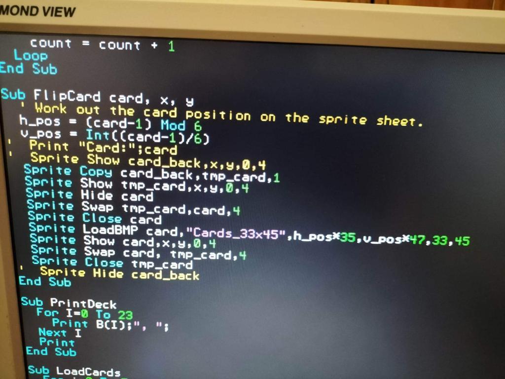

The example you've given is not quite demonstrating what I am trying to achieve.  Your example continually swaps between two sprites.
I'm trying to change the graphics of a sprite.  I swap from a temperary sprite to the active sprite, and that seems to work, but when I delete the temperary sprite, the active sprite disappears.
Once I've done the swap from the temperary sprite, I want to load new graphics into it to swap into the next active sprite, but that causes an error.
Fundamentally, all I want to do is change the graphics of an active sprite.  I have 24 active sprites.  When I flip a card, I want it's graphics to change from the back of the card to it's face value.  If cards weren't being moved and overlayed, I may be able to create the sprite on the fly from the background image, but I'm trying to make the visuals more animated.
I'm not sure that I really understand what SPRITE SWAP is doing.  Is it just swapping the graphics of a sprite, or is it changing everything about them, so that the new sprite (number included) takes the place and all the attributes of the old sprite.  If the later is the case, then this won't work for my scenario as written, as the sprite number is related to the face value of the card.
What I'm after may not be possible within the current framework, but I'll give it a good try to make it work if I can.

Thinking of another possible solution:
SPRITE LoadBMP 1 ' Card back
SPRITE Show
SPRITE LoadBmp tmp ' Card back
SPRITE Swap 1, tmp
SPRITE Close 1
SPRITE LoadBmp 1 ' Card face value
SPRITE Swap tmp,1
SPRITE Close tmp
It's long winded, but this may work, if SPRITE Swap behaves how I think it does.

Yay,    this solution worked...well sort of.
SPRITE Show
SPRITE Swap 1, tmp
SPRITE Close 1
SPRITE Swap tmp,1
SPRITE Close tmp
To try and speed it up a bit, and not read from the SD card twice, I decided to SPRITE Copy tmp from my existing card back sprite, as I do when creating and dealing all the other cards.
So it actually looks like this:
SPRITE Copy back,tmp ' Copy card back to tmp sprite
SPRITE Swap card,tmp,4
SPRITE Close card
SPRITE LoadBmp card ' Card face value
SPRITE Swap tmp,card,4
SPRITE Close tmp

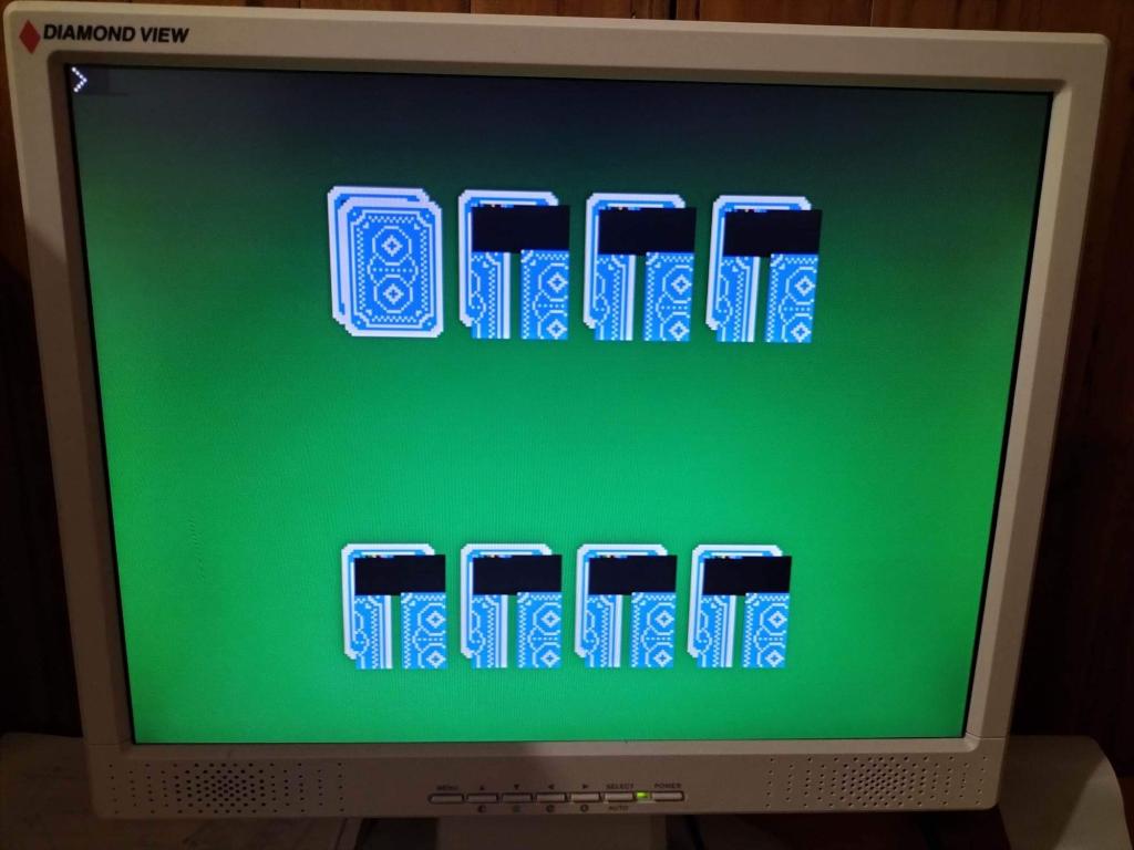

Tweet showing sprite error.
As you can see, the speed has not decreased noticeably, and the black is no longer transparent.  (Thanks Peter) But the sprite image data is being corrupted as I move it across the screen, but always after it has worked successfully four times.
I know that I must be doing something wrong somewhere, as when I go to edit the program after it has run, I get a brief message flashed up on the screen that says "<something, something something>: Resetting", and the the Pico resets.
Help...please
Hawk
[Update]
The error reported when I try and edit the program after running it is:
"Error: Invalid Address: Resetting"
Edited 2023-05-18 18:54 by Hawk

The program should give an error but you are so far outside of the design concept that it is not surprising I haven't trapped it. Copy works by creating sprites that reference the master. In normal use if you try and close the master you will get an error if copies are still open. By using swap you are circumventing this check leading to corruption.
For your application I would use framebuffers and blit with framebuffer copy after each move
Edited 2023-05-18 19:18 by matherp

I finally found some time to do some testing.
This new version certainly gave a new set of error messages, that I presume were added to avoid getting into unstable states.  It took me a while to find a sequence of commands that didn't give an error.  When I finally did, I got similar screen corruption to the last video I posted, and no error message.  So there may be a scenario that's not being detected yet.
Unfortunately, I am still unable to find a way of loading a new image into a sprite without it disappearing and then reappearing.  My thoughts of animating the flip have totally gone out the window, and it looks like the current solution that I have will be the compromise I live with on this platform.
Thanks for all your efforts Peter.

Sprite Copy card_back,tmp_card
Sprite Show tmp_card
Sprite Hide card
Sprite Swap tmp_card,card
Sprite Close card
Sprite LoadBMP card
Sprite Show card
Sprite Swap card,tmp_card
Sprite Close tmp_card
To achieve this code I had to rearrange the order of things to eliminate each error that occurred in turn.
