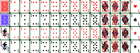

That's a nice solution.  I have been working on the movement of cards on the display.  At the moment I'm having tearing issues.  Not sure whether to solve them using delays in the move routine, or use double buffering.  Double buffering seems like overkill.
I'm working with a new set of card images based on these from Michael B. Myers Jr, which were designed for the Pico8.
(This version has already been colourised to the PicoMiteVGA's palette.)
The non-picture cards would be much easier for you to create.  The picture cards, however, have many more colours.
