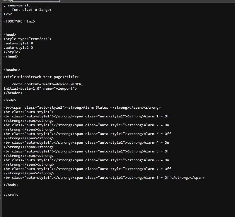

However when I download to Picomite W via MCC Xmodem one displays perfectly and the other one is corrupted.
First one - Displays perfectly and via Picomite
Second one - Displays perfectly when opened direct in browser
However when second one is uploaded via xmodem to Picomite and called to browser via ip address it does not display and is corrupted.

For reasons I don't understand your html is using a vast amount of either system stack or system heap - I think stack. The text "sans serif" is a result of memory corruption. Now this text  doesn't appear in the firmware anywhere so it must be coming over the web from the host but doesn't appear in the normal html header.
I've made a change, posted in a29, which allows your code to work but if you put a syntax error in the interrupt routine so the program aborts then you can't edit as there is still corruption. I would suggest trying with an external CSS file but this is now beyond my knowledge.

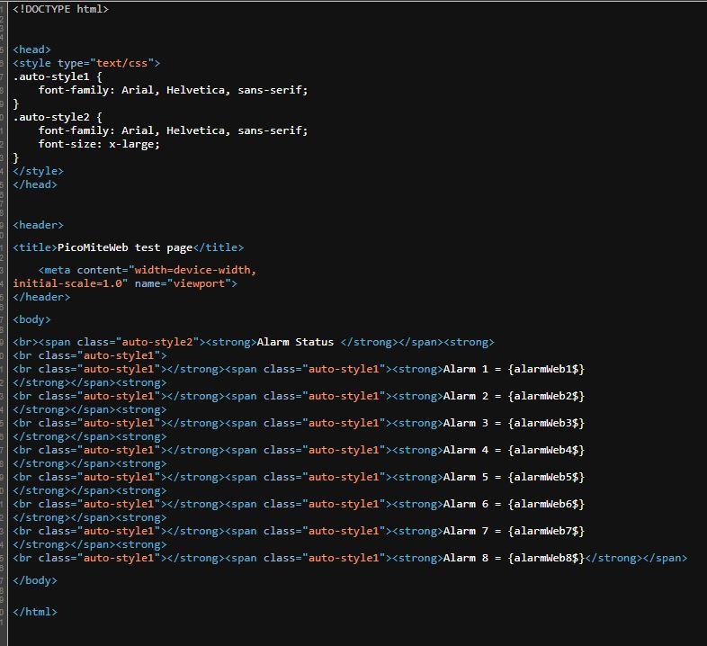

Posts: 6626
Posted: 02:11am 24 Mar 2023
Your html code uses {} in the style definition.
MMBasic thinks that is a variable and replaces the contents with zeros
You need to double up on the {s to make the code work as expected.
I 'think' you only need to double the { to {{.
Not sure if the } needs the same treatment. The page seems to render without changing the } to }}

Posts: 6626
Posted: 02:37am 24 Mar 2023
When you place {{ in the html code, MMBasic will convert it to a single { before serving the page.
If you want to look at the code before you send it to the picoW, then, yes, the browser will see the double {{ and get annoyed.
If the style definitions were in a separate file stored somewhere other than on the pico, the definitions don't need to be altered.

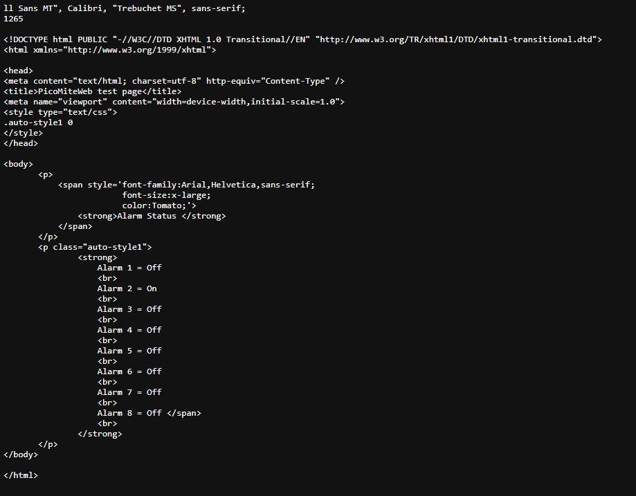

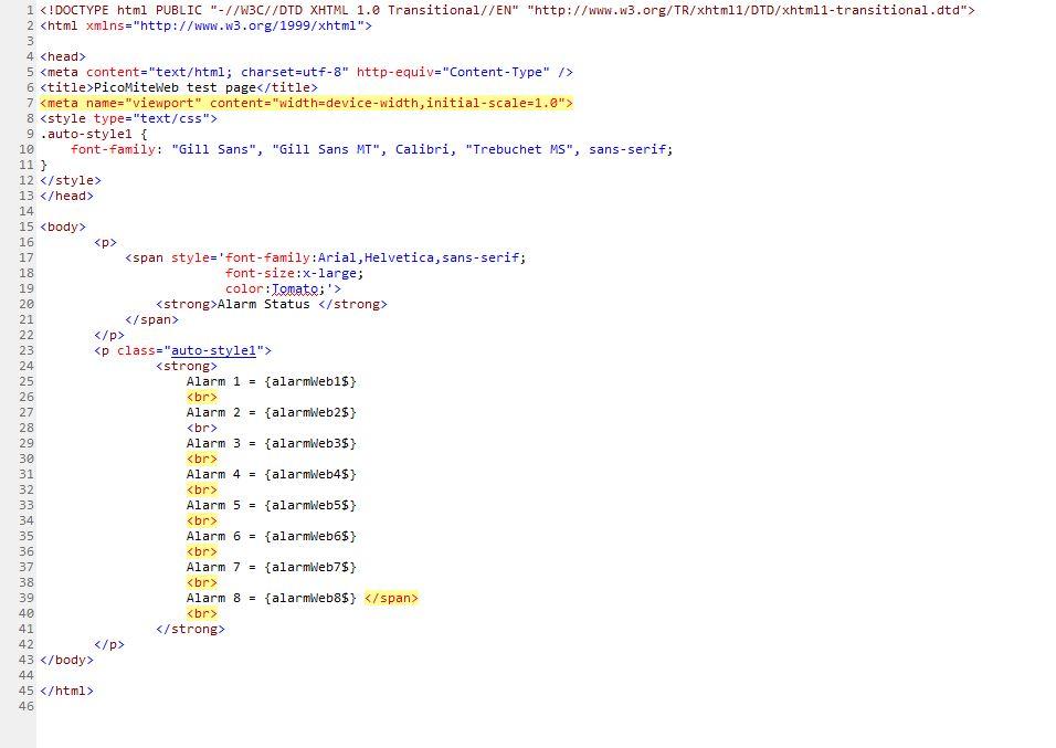

Tried Doug's html and guess what no problem, however when loading into Expression 4 and  adding a font this is the result as generated
But on running and looking at the page source this is the result
Guessing .auto-style  on line 9 is the cause of the problem ?

Once again, your code has a single { which MMBasic thinks is the start of a variable. Make it a {{ and all will be well again.

  TassyJim said  Once again, your code has a single { which MMBasic thinks is the start of a variable. Make it a {{ and all will be well again.
Just realised that these { were added by Expression 4 as in
.auto-style2 {
font-size: x-large;
color: Tomato;
font-family: Cambria, Cochin, Georgia, Times, "Times New Roman", serif;
I missed this and your previous comment had not sunk in
All is good now thank you.
