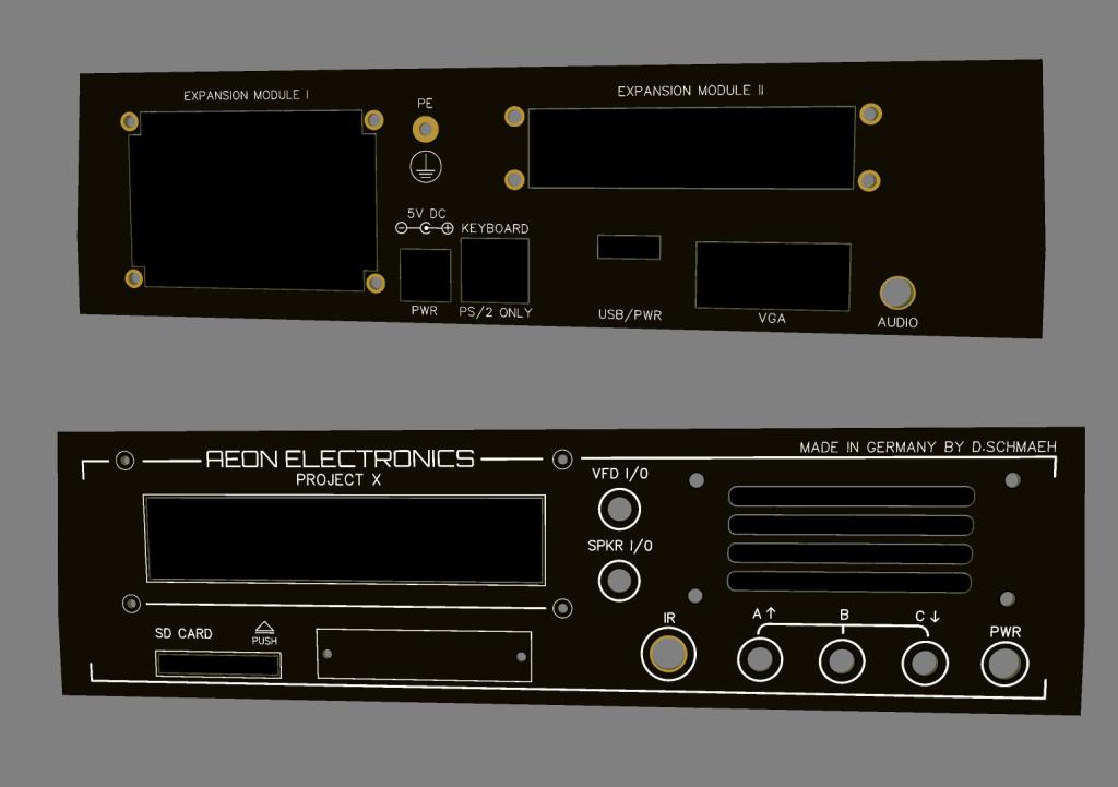

Even though I am not that helpful with answering questions about basic, I try my best when it comes to circuit or pcb design - those are my strengths. So you can use my Gerber files and even the raw PCB-files (if there is interest) so you can modify it to suit your needs.

My plan with this PCB project and the attached VFD is to have an "alround" PicoMite, which can be a base for all kind of projects. This is why I call this interation of PicoMiteVGA "Project X".
3 Buttons, a VF-Display (cool retro stlye) an integrated amplifier with speaker and the GPIOs are INTERNAL for a good reason. I left much space so one can integrate additional PCBs.
On the backside panel I left two "expansion module" slots, so you can mount whatever you want into / onto it. I already built a radiation counter with a geiger tube; this is one application, for example, to fit in.

May all this inspire you for own projects, I've attached you all my design files here, even the raw PCB files, so you can modify it of course:
