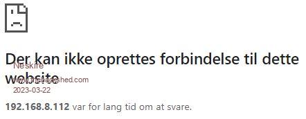

Then I switch PicoW1 and PicoW3 to a Huawei Soyealink B535-333 router (with internet) and some issues showed up.
"Unable to connect to this website 192.168.8.112 took too long to respond.
ERR_CONNECTION_TIMED_OUT"
It takes from minutes to hours before it stops responding to a page refresh. Same experience with PicoW1.
The only  way to get it working again is a Power reset. The MMBasic seems to be working ok.
Anyone have an idea what's going on? My knowledge of tcp/ip communication is limited.

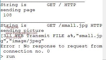

The 3 PicoW's connected to the Huawei Soyealink B535-333 router all failed.
Then I switched PicoW1, PicoW3 and PicoW4 to a Huawei B525s 23a router.
After a short time PicoW4 stopped with an error.
Picow4_Huawei_error.zip

How is this possible ??
Restarted PicoW4 and all have now been runnig for 40+ hours, great.
My conclusion: the Huawei Soyealink B535-333 router has an issue with the PicoW as an IOT.
I will now ask my ISP why (both Huawei router has been supplyed by them).

Posts: 6626
Posted: 07:59pm 25 Mar 2023
Try extending the timeout
OPTION TCP SERVER PORT 80, 10000
