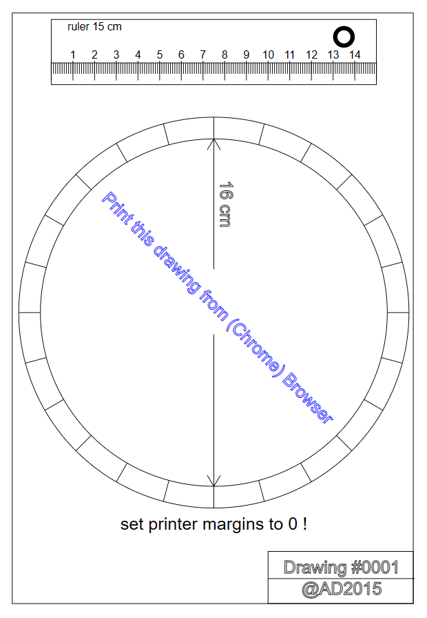

PicoMiteWeb with SVG Graphics
Creating diagrams as bitmaps can be a challenge without a result.
But we have the vector graphic option as SVG code and/or files.
Dim myfloat!=16.123
Dim myint%=999
Dim mystring$="The PicoMite Web is GO!!!"
Are defined but not found in the source code of simpleweb.bas,
because you find thes variables within test4.html under
<h1>{mystring$}</h1>
Test of a float: myfloat is {myfloat!}
Test of an integer: myint is {myint%}
Test of a string: mystring is {DateTime$(now)}
So WEB transmit page a%,"test4.html" interprets and replaces as an example {<h1>{mystring$}</h1>} by the content of the known
variable mystring$ into <h1>The PicoMite Web is GO!!!</h1> automatically.
That can be used to integrate SVG graphics directly within the a HTML file.
See
https://www.w3schools.com/graphics/svg_inhtml.asp
and
https://www.freecodecamp.org/news/use-svg-images-in-css-html/
But you can also create a separate SVG file and transmit by:
WEB Transmit FILE a%,"rulers.svg","image/svg+xml"
Here is a BASIC example manly created by Aat written in OliBasic for Android at
https://www.tapatalk.com/groups/rfobasic/generating-a-pdf-t6255.html#p47019
This example should be readable for BASIC programmers.
I have to explain that the function WORD$(GrTextDraw$,3,",") returns the third text part of the CSV string GrTextDraw$ delimited by ",".
One of the results
Happy coding
Gregor
