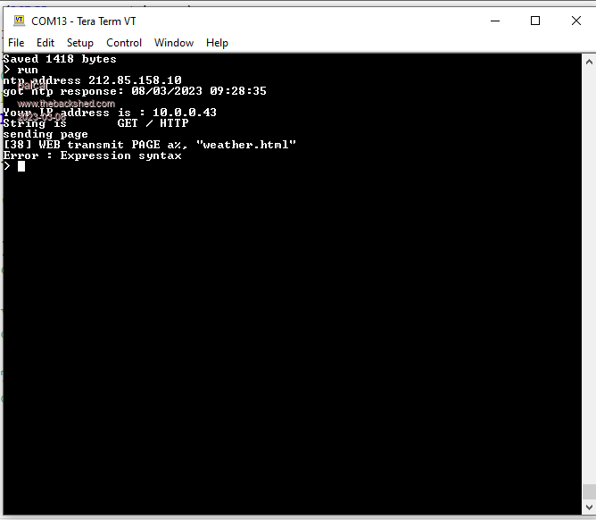

Can someone tell me what is wrong with this ?
I also have the file "first.html" in A: and if I substitute the word first for weather in the problem line it works OK ?

Getting somewhere I thought the error was in the line
WEB transmit PAGE a%,"weather.html"
but it is in the file "weather.html"
I've jumped the gun and used <br>
and <pre> and forgot one of the <
Edit. I also edited it in Libra Office and although I saved it as a HTML document in didn't open properly, so I edited it in Notepad and selected All Files and it now works as expected.
Edited 2023-03-08 13:19 by palcal
