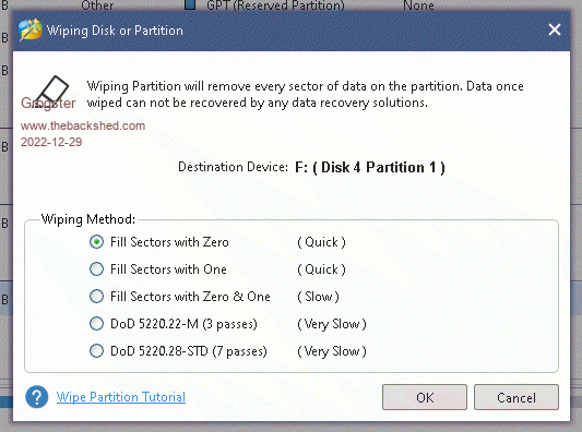

MiniTool Partition Wizard has a tool called WIPE DISK, and you can select from a few different options including fill with zeros, fill with one's, fill with alternate zeros and ones, 3-pass wipe and 7-pass wipe.
Which one would the members here suggest?
I am thinking of the simple fill with zeros(quick) option.

The multi-wipes are a waste of time - completely unnecessary unless you expect the security services are after your data.
Yes go for the zeros (or one or any pattern) :)

"Simple Overwrite (1 pass)" overwrite method writing 0s or random data does the Job.
