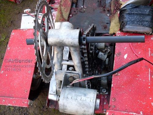

This is the gearing it ran which has been just sat back in place for the picture.

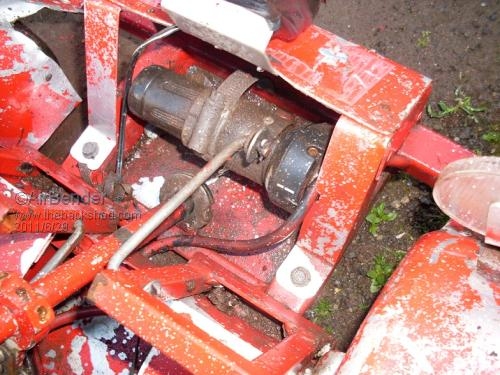

I used a 24 volt DC motor of an electric scooter with 2 12 volt motor bike batterys.

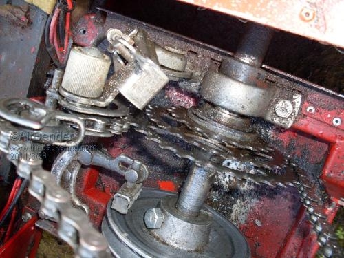

It ran two chains one from the motor to the large sprocket and then one from a small sprocket through a derailer to the three sprockets on the main shaft.
This set up worked very well I can only remember it losing a chain once in years of operation. Just a normal bike derailer was used.
This is the gear shifter which was linked to the derailer by cable which gave it three gears.

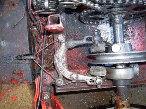

Here is the brake. A bike brake on an alloy pully which worked well.

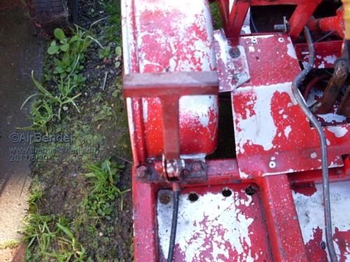

Here is a picture of the accelerater set up.
It is the original scooter hand throtle linked to a foot pedal.
