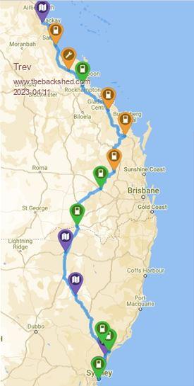

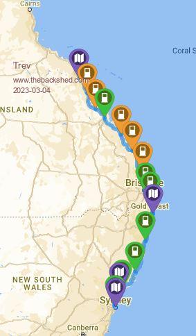

Here is the plan for driving to Sydney.
Use https://www.plugshare.com/ to find the charge stations you need.

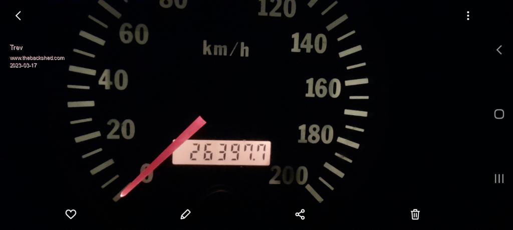

Ready to go. Speedo reading 22350km
Images won't upload
Edited 2023-03-04 19:28 by Trev

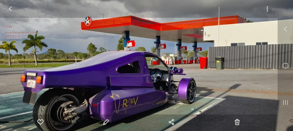

Left Rockhampton at 3.24pm

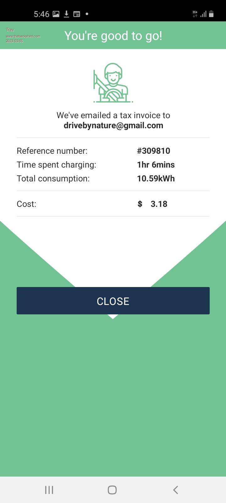

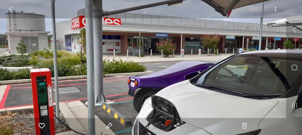

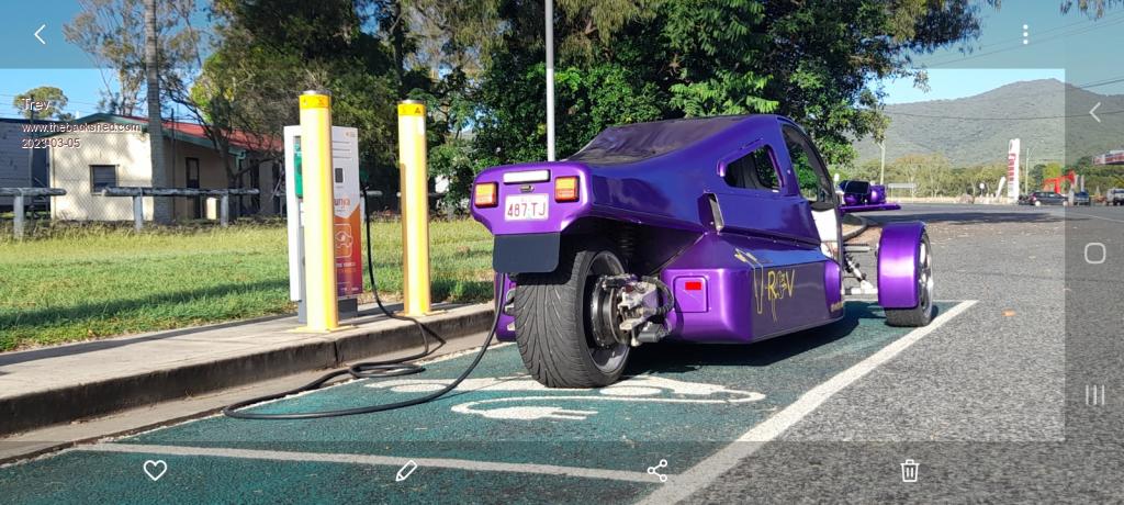

Decided to stop at Mt Larcom. I saw on plugshare website, 2 Tesla's at Miriam Vale requiring the Type 2 AC outlet (the outlet I use) because the fast DC was broken.
Drove 79km.
Used down to 70%
Again only 2 phases connected but 32A, so still got 60A charge rate, 2 chargers on one phase.

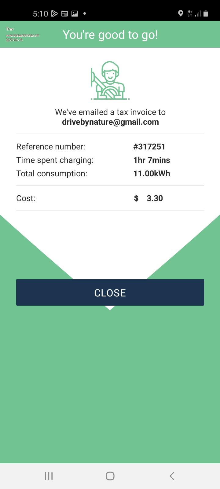

Charged to full. 1hr 6min
Cost $3.18
Edited 2023-03-05 17:48 by Trev

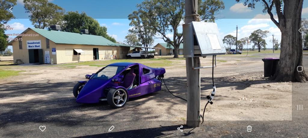

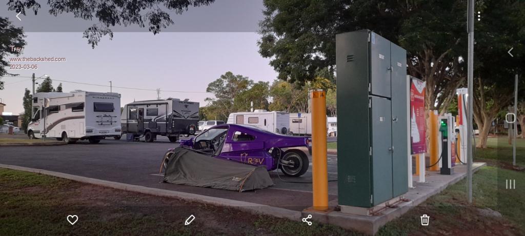

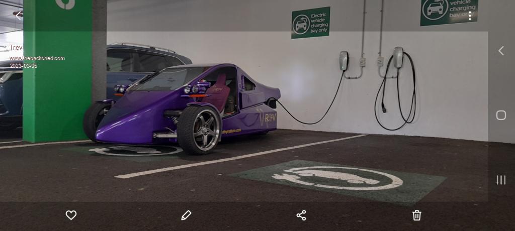

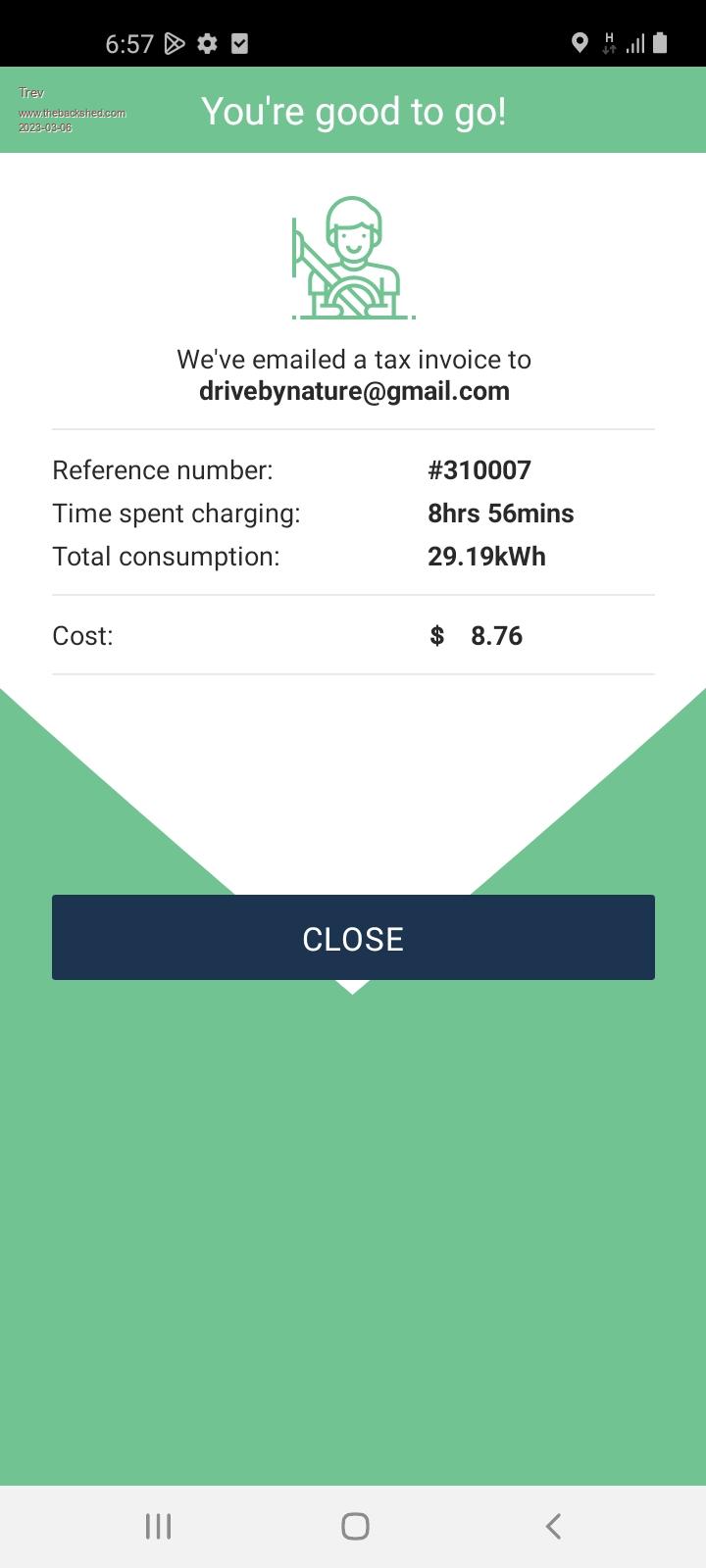

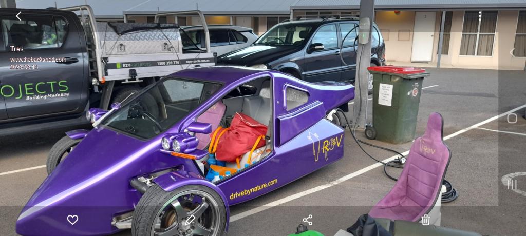

Arrived at Childers 9.54pm. Got plugged in and set up swag for a sleep. Strange, only 2 chargers working, but no big deal, it was plugged in for the night.
Battery voltage was quite low. Down to 13%. Not to be done on a regular basis.
Drove much slower to make 248km.
Better timing than Canberra trip, getting in at 11.08pm
It was plugged in for 8hrs 56mins, but I got up around 2am to check the end of charge - all was good. Cell balancing functioning.
Cost $8.76
Picture taken this morning, day2.
Trev @ drivebynature.com

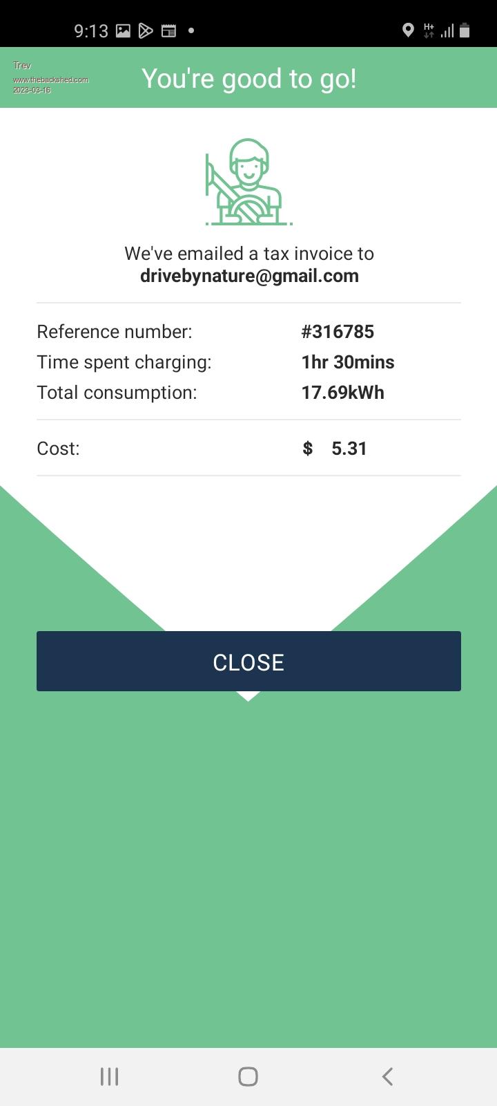

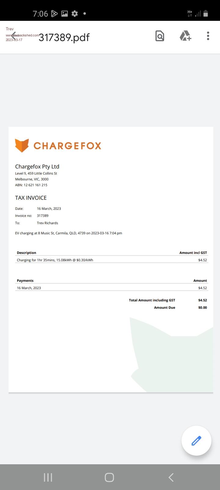

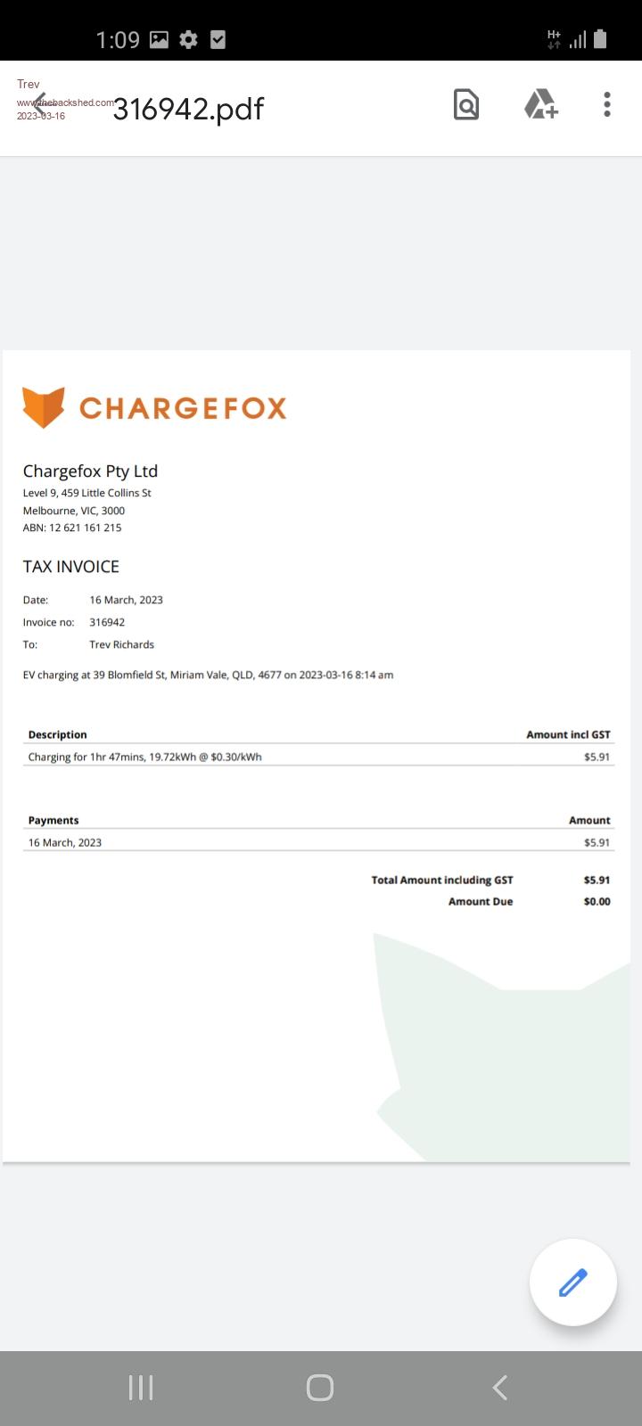

Somehow I lost the screen when I went to disconnect, so this is the invoice Chargefox emailed.

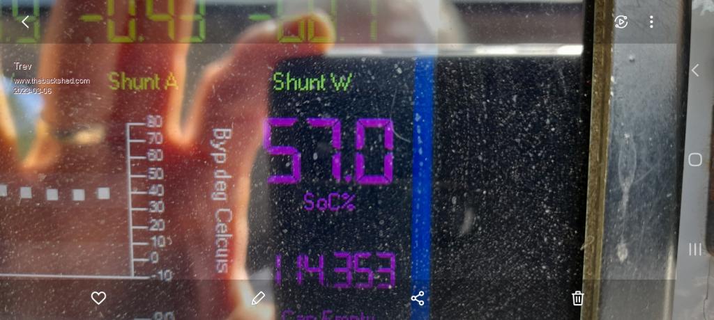

Posted: 04:25am 06 Mar 2023

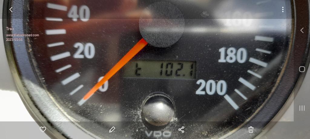

Further to the range question posted....
From Gympie it goes into freeway. I drove at 100kmhr for 102km and battery was down to 57%.(used 43%). 102km because I had to have a safe location to pull off.
So theoretically it should do 200km at 100km/hr
I have done testing at other times. If I remember right, at town speed, 60km on smooth level road could be as high as 360km range. But of course as said, there are a lot of variables that will affect the range.

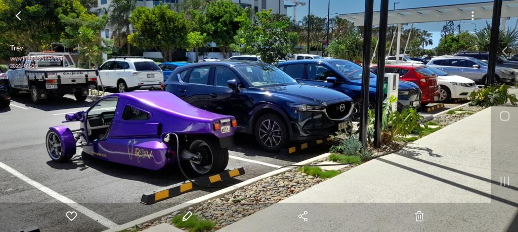

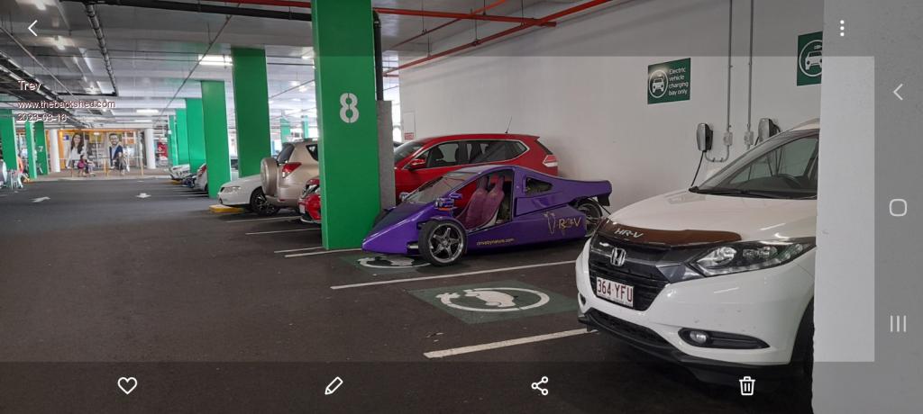

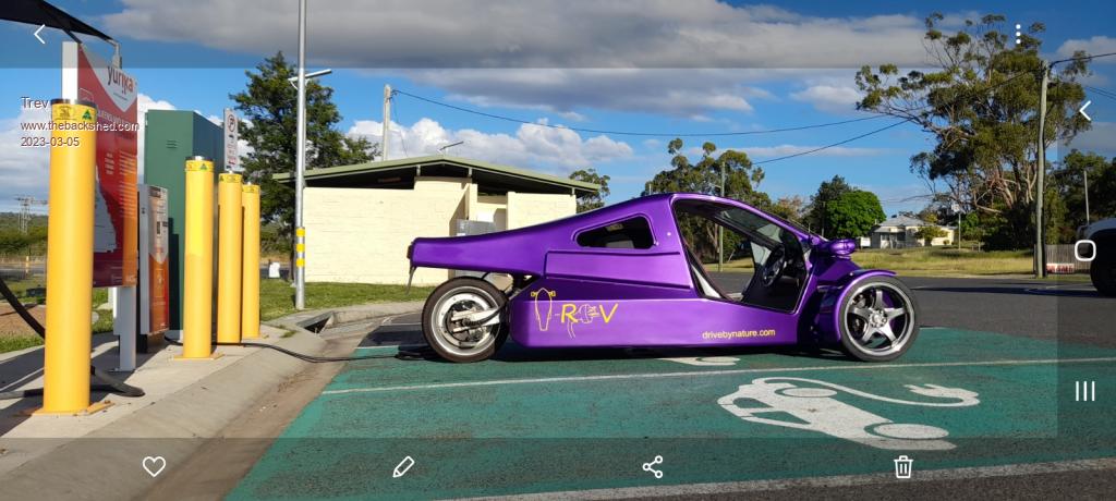

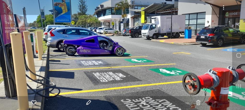

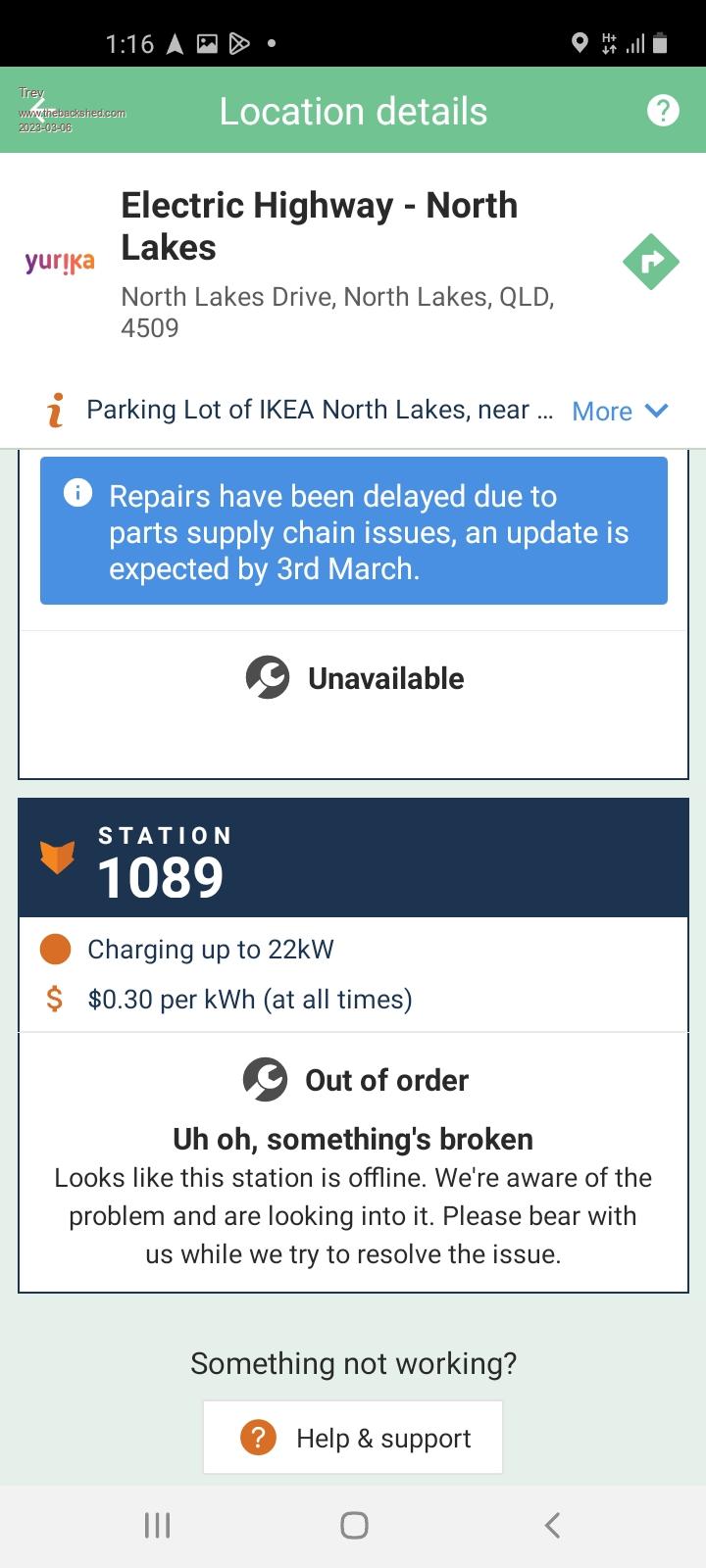

Went to IKEA North Lakes, but it is out of action
Currently charging at IGA Redcliffe.
Cost $Free (there will be no record either)
32A
See the Type 2 outlet in the garden in front of the 2 dark coloured cars. The one directly beside T-Rev is an ICE car.
After here I am going to have a catch up with a long time friend who lives in the area.

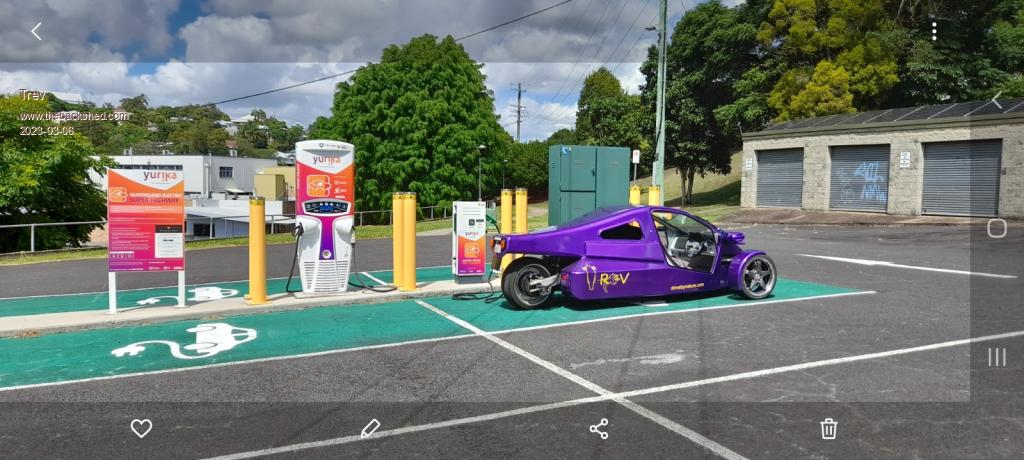

Of all the parks in this carpark (IGA Redcliffe) this is the most commonly used spot, where the silver car is. All ICE cars.
Right next to the EV charge outlet.

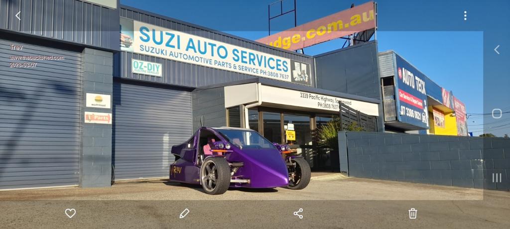

Posted: 09:42pm 06 Mar 2023
Day 3.
Left Redcliffe at 5.30am. Forgot to look at the clock, but arrived at Suzi auto/ OZ-DIY maybe around 6.40am.

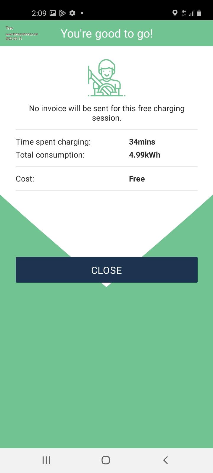

CAN control charger working again this morning.
Charged approx. 1hr.
Another free charge. Thanks Graeme. Graeme also does EV Conversion. We see ourselves as friends in business, not opposition.

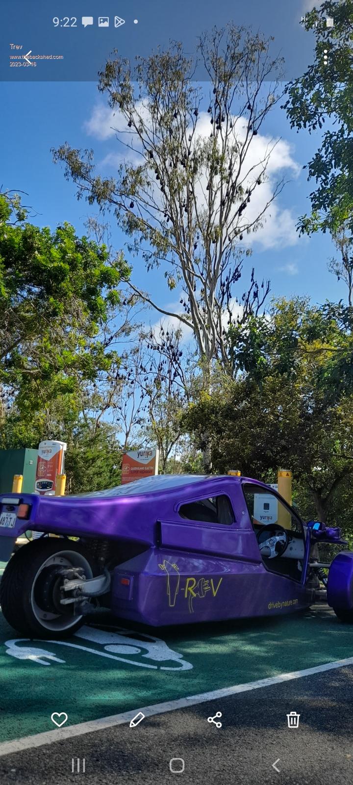

Posted: 02:19am 07 Mar 2023
Had a re-think about charge stations. Decided to miss the free power on the pole at Burleigh Heads and stop at Gold Coast Airport. That way, if the next station at Epic shopping centre down at Lennox Head doesn't work, then I have enough power to make it to Grafton.
I am glad I don't live in the Gold Coast part of the world. The traffic is terrible. Traffic jams and crawling on a 5 lane freeway is not for me.
Arrived at Gold Coast Airport charge station at 9.23am
Used 24% of battery (down to 76%)
Drove 80km. Some of that at extremely low speed.
80km for 1/4 of the battery, makes 320km range in those (not normal) conditions.
