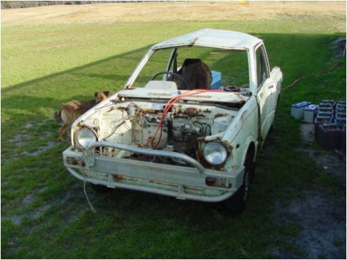

I was running out of things to play with.... and then at the tip, I saw a very very sad Suzuki swift. It had been cut down and used as a shooters vehicle, with no bonnet, no rear bodywork, crushed roof, no drivers door, smashed windows and windscreen, and totalled motor.... this was just the thing...... an Electric Vehicle to play with (soon to be).
So it was out with what was left of the motor, find a tyre for the front and then a quick conversion.
It looks like this I'm afraid....

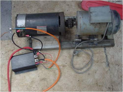

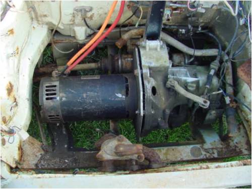

I quickly made up an adapter plate, and made a coupling out of the two sprockets with dual chains to connect them face to face. This would be the universal coupling, and bolted it into the gearbox housing. The plate was cut from the hull of an old ship. (waste not want not). I grabbed the 4kw motor I had used for the grid tie experiment... note the chain adapter/coupling:
and plonked it in like so.

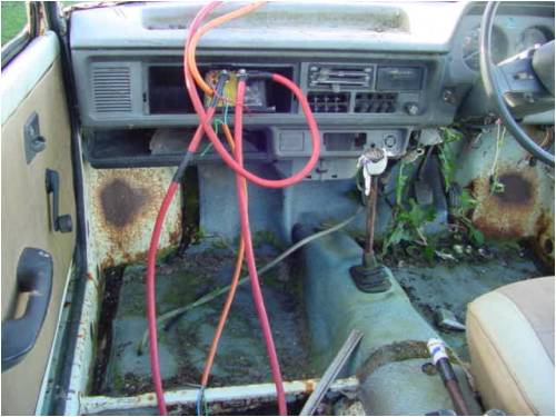

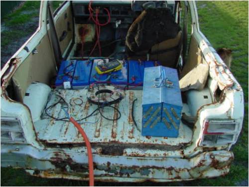

The electronics were wired into the car... perhaps wired is too strong a word, thrown into the car describes it better, and became housed in the glovebox. The 1204 controller I blew up when testing the 12v water heater,( a poor battery connection let the voltage rise to high for a split second, and blew some of the fets and other bit ans pieces.... not like Trevs though,) but with judicious use of hot glue, it is back together again. The careful wiring job looks like this:
The batteries were tossed in behind the seat, wired up and we have an EV (forgive me Trev for even using the same name). Here we see the batteries and the input line from the mill to charge them up. The seat was missing before I dragged it home. The roof was caved in but by carefully panel beating it (sat in the seat and pushed it back up), it will keep the sun off anyway.
All that remains is a quick fill of power and were away.

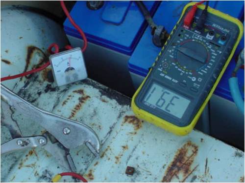

The mill does fairly poorly charging at 36v, so 20 amps is about all it will get up to, but at that rate it fills up pretty quickly.
Soon it was up to 42v,and it was time to go for a howl.

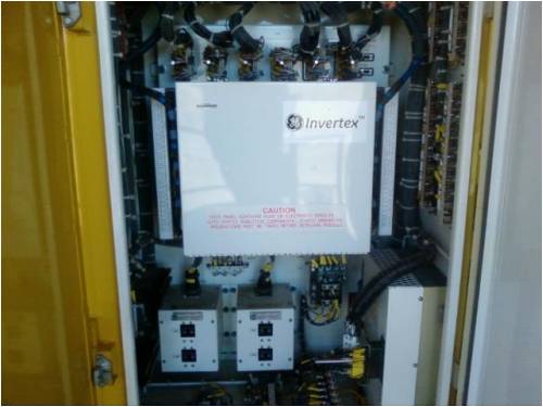

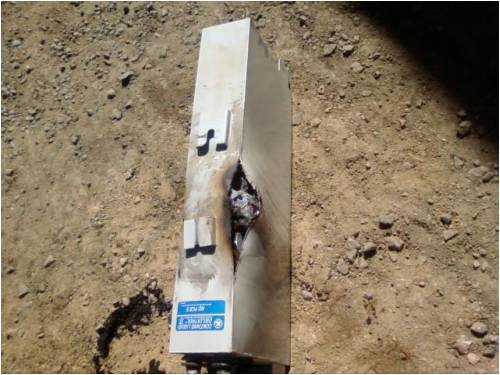

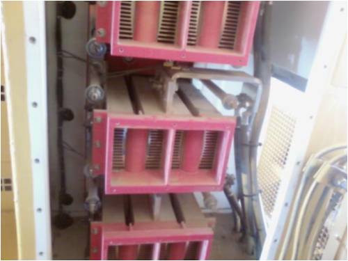

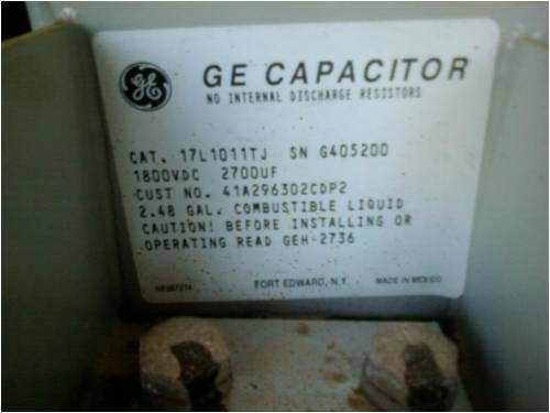

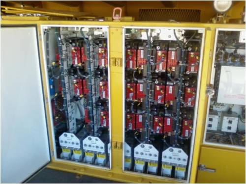

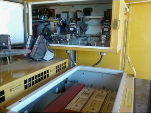

You might get a little buzz out of these pic's I snaped the other day of the electric cabnets on the trucks here , and a couple of a cap blow up...
3 phase rectifier
phase modules and cap bank
Inverter and optic fiber controlls for phase modules
DC breakers for the dump load
Would these caps be good for our testing
Letting the smoke out ...BIG BANG !!!
