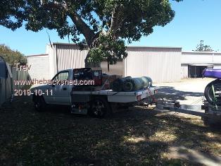

We have done quite a number of Electric Vehicle shows over the years. Not long ago I posted several of those trips in the EV 7  thread starting part way down on page 2 and going into page 3.
A few weeks ago, we went to Yeppoon Sustainability Expo. Glen George came along for a test run in preparing for the big drive to Sydney, AEVA Electric Vehicle Expo. Glen is the owner and driver of the first Electric Vehicle around Australia. Check out Glen's websites http://co2race.net/  https://www.facebook.com/The-Great-CO2-Race-205319656190698/
Here is some pictures of the Yeppoon trip and show.............

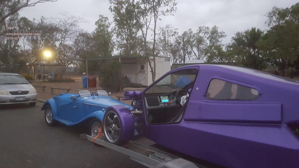

Left Mackay early in the morning.

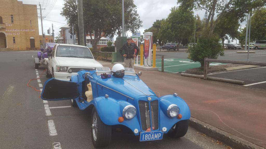

Charging at Sarina and Carmilla

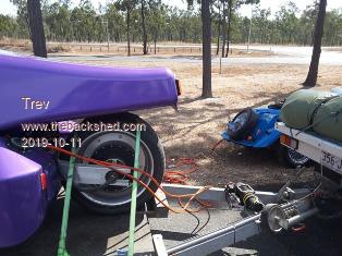

Dumping power from T-Rev to MGEV at Waverly Creek and charging at Marlborough

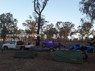

Camped at Yaamba. Next morning dumped power from T-Rev to MGEV

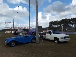

Drove to Yeppoon. Booked into a caravan park and got MGEV plugged in. Glen and I went driving in search of bigger power. Found the local showgrounds (thanks Dale for the location) and negotiated a charge with the caretaker. After charging EV Hilux and T-Rev, went back to the caravan park.
Next day was the Sustainability expo. Quite a big turn-out for the first of such events for Yeppoon.

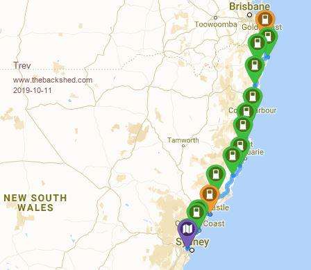

Here is the map of our planned charging stations. There is a lot more charge sessions for MGEV, than shown on the map. MGEV only has a 70-80km max range now. The charge stations are not that close, hence the reason for dumping power from T-Rev to MGEV.
The plan is divided into 2 sections, so the tablet (for traveling) can handle the amount of data.

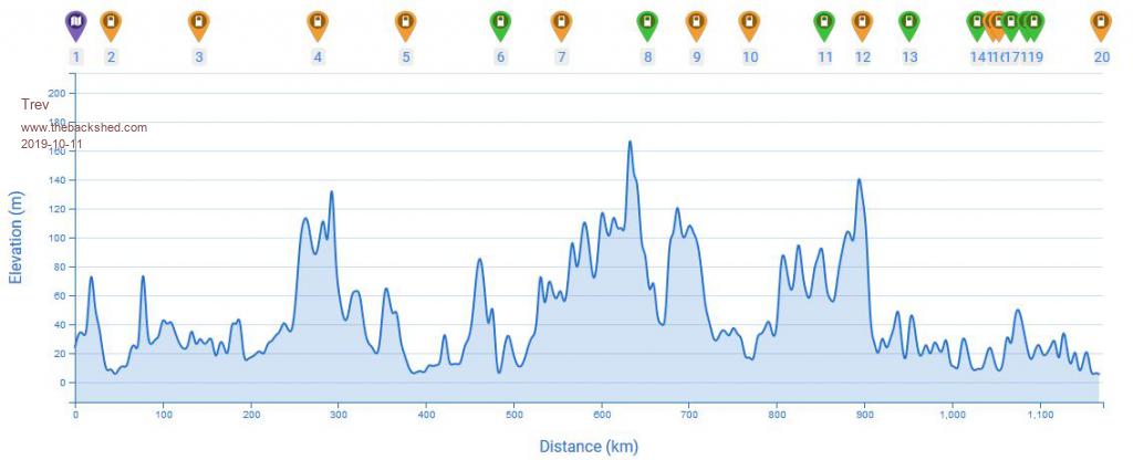

And another piece of valuable information is the Elevation Charts. If you are going uphill, it does take more power. A head wind also uses more power, but that has to be played on the day. Pulling the trailer with T-Rev (1100kg) also takes a lot more power.
Kuttabul to Gold coast
Gold Coast to Sydney

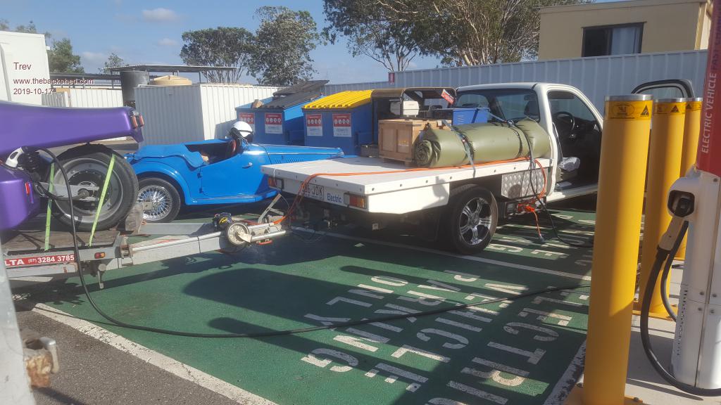

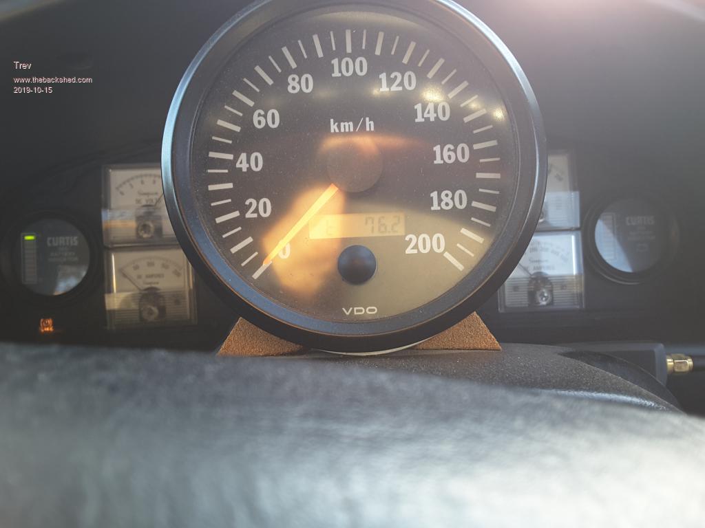

I left home, Kuttabul Qld,  at 4.38am. Met up with Glen George at Mackay at 5.30am.
Drive to Sarina. Forgot to photo the speedo reading at home. In Sarina trip meter which zero at home, shows 76.2km and main reading shows 92700.1km. So speedo reading at home would have been 92623.9km

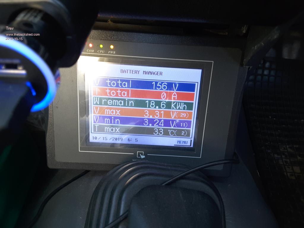

Dumping power from T-Rev to MGEV 9.15am. After MGEV, I will connect it up to dump to EV Hilux. EV Hilux used 18.6kW to drive the 76.2km. That's 4.1km /kW x 26kW = 106km range.
Trev @ drivebynature.com

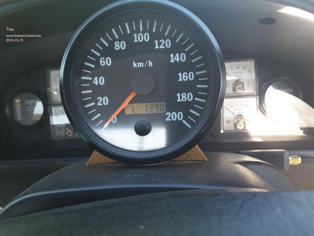

Left Sarina at 7.23am. Most of our driving is at 60km/hr.
Sometimes we do the speed limit, in town and down hill! It really sucks when you have a really long steep downhill and you have to use the brakes
Arrived Carmila 8.30am
I had fitted a 3rd charger to T-Rev but hadn't finished the wiring, so after connecting EV Hilux and MGEV, I finished that off. Then got T-Rev charging. Also a number of people come off the street and want to talk. One fellow had alternator trouble in his Nissan (petrol) and a local had told him to come and see me (at the charge station). He said the local told him that I was the guru. I wouldn't  say that, some things I dont know. Once I got stuck in Miriamvale. My phone went flat, so can't switch on the public charge outlet. Can't ring anyone. I wanted to change the SIM from phone to tablet. Didn't know how. I had to get someone on the street to help me change the SIM. The comment was, built 2 electric cars but cant change a SIM. The big joke of the day.
For the 139km from home to Carmila I had used 24.5kW plus 57Ah from T-Rev. MGEV took 40Ah. Total out of T-Rev was 97Ah. MGEV used about 55Ah from Sarina to Carmila.

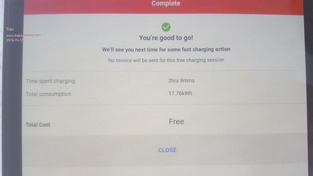

Recorded 36.8kWkw and 2hrs 6 min from port A and 15.89kW and 2hrs 0min from port B Chargefox app. (The app that is is to turn on the charge outlet)

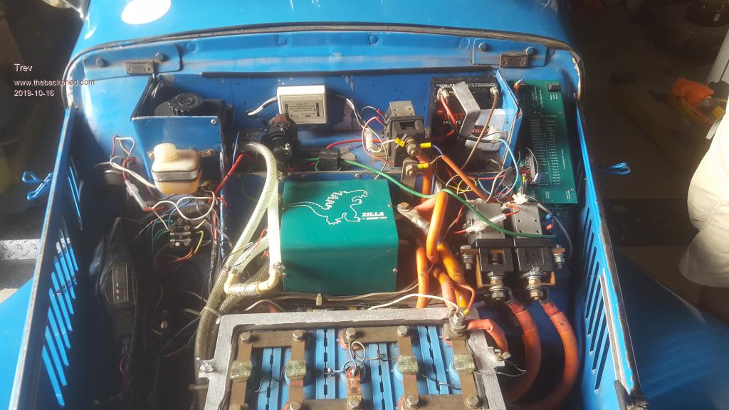

Well, plans do change.
We were about to go from Carmilla, but MGEV would not switch on. We traced the problem down to the Zilla speed controller hairball. No way to fix it, decided to leave it, take T-Rev back home, dump it off and go back with the empty trailer to pick up MGEV.
Wednesday we fitted a new Soliton speed controller. Then found the Zivan charger had also blown a fuse. Many hours tracing all the wires to find the problems.

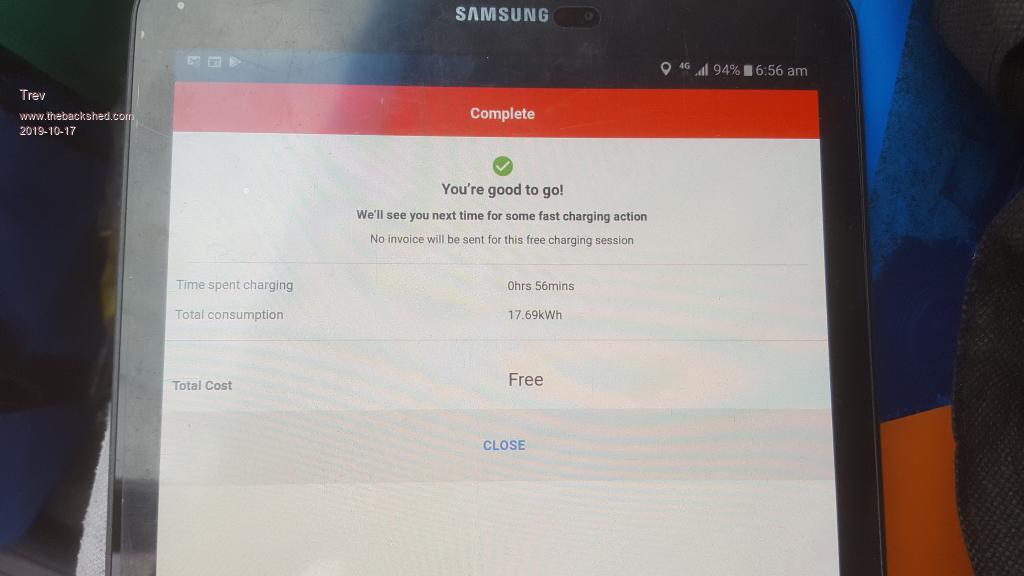

Posted: 08:59pm 16 Oct 2019

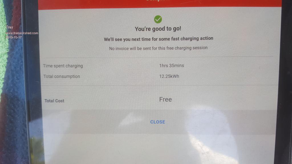

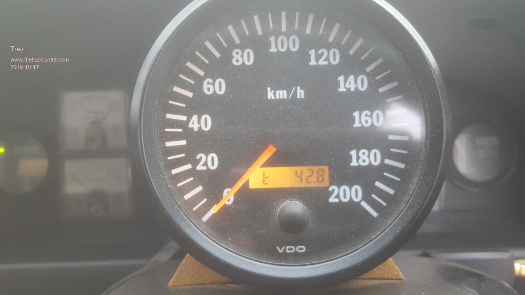

3 vehicles, home, Kuttabul to Mackay, 42.8km, EV Hilux used 9.6kW recorded on its monitor.
Chargefox app recorded 56 minutes 17.69kW.

Sarina 7.45am.
Dumping power from T-Rev to MGEV.
At first, we thought we had more problems. No power tranfer. Glen plugged in only half the Anderson under the back of MGEV. Connected correctly.....all good.

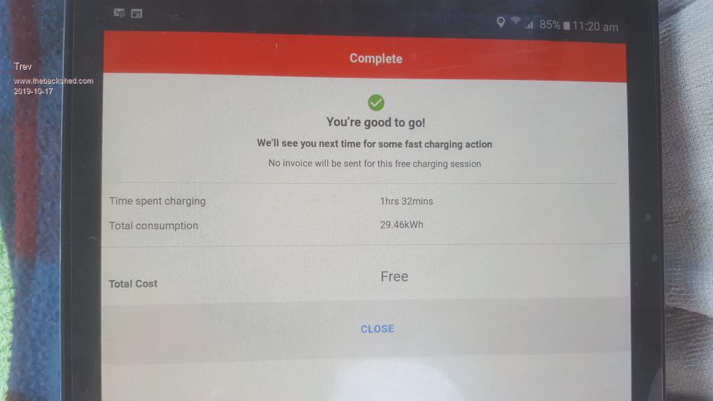

Trev
Joined: 15/07/2006
Posts: 676
Posted: 04:02am 17 Oct 2019
Got to Carmilla at 9.40am. MGEV Zivan charger did not work. Spent some time on that issue. Bypassed BMS to get 240vac into it, but still output.
Pictures of Chargefox reordings
Left Carmilla at 11.25am. Arrived at Waverley Creek rest area at 12.55pm. Some roadwork holdups in that section of road.
Dumping power from T-Rev to MGEV. Then EV Hilux will get some from T-Rev

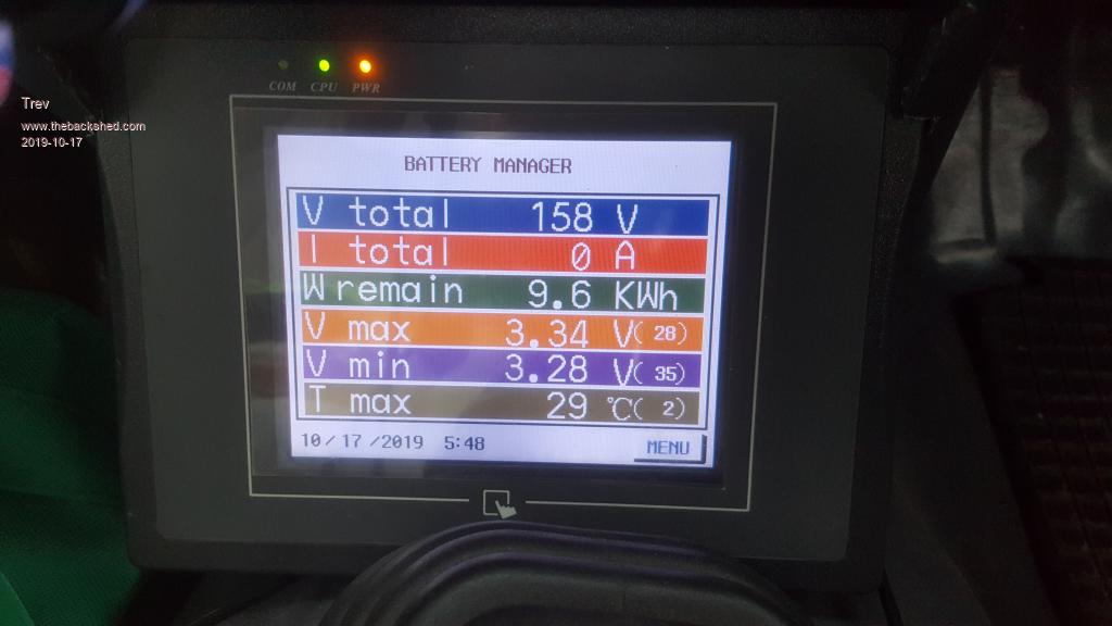

Arrived at Marlborough 3.23pm.

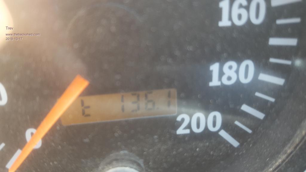

Did 136.1km from Carmilla. EV Hilux used 24.2kw plus 58Ah from T-Rev. MGEV took 48Ah from T-Rev at Waverley Creek. Total out of T-Rev 106Ah. MGEV used 60Ah from Waverley Creek.

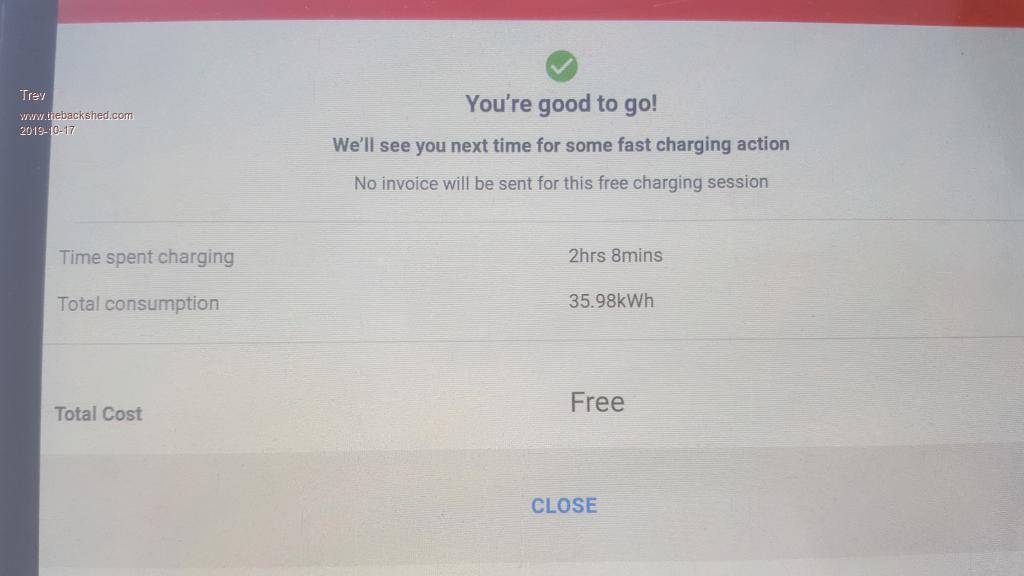

chargefox recordings
Leaving Marlborough charge station now 5.47pm

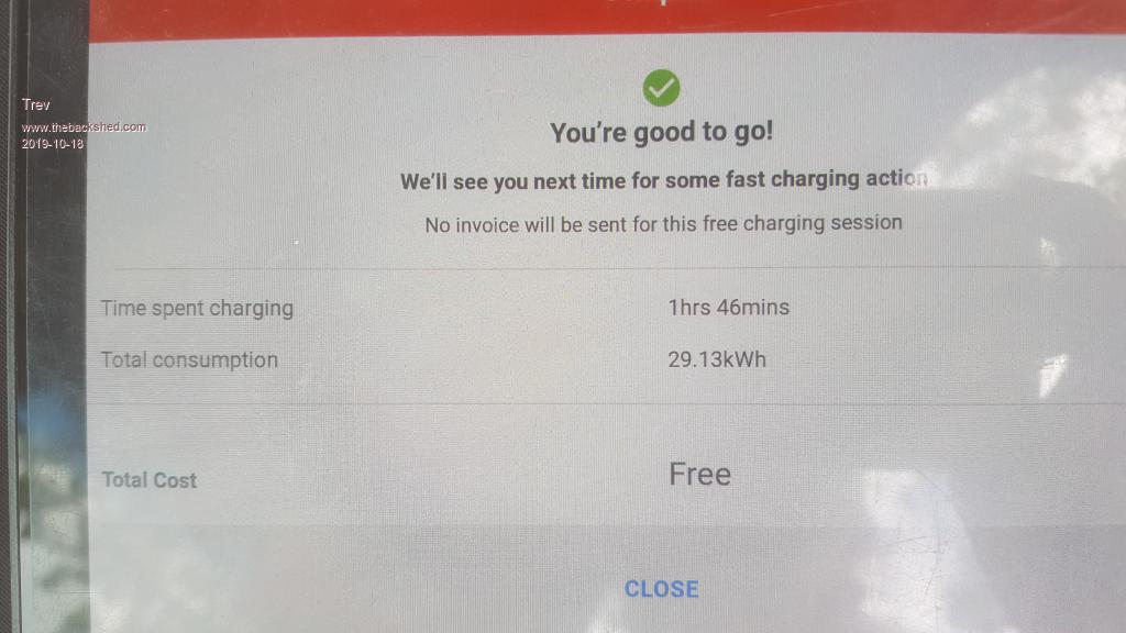

Posted: 02:07am 18 Oct 2019
We had the perect Driver Reviver at Yaamba
Got up just before 5am. Thought to hit the road at 5am but as soon as I was walking over to the EV Hilux the first person walks up with lots of questions. Ah, all good. Half the reason for the trip is education anyway. Got going by 5.40am
Got some fittings and hose at Bunnings in Rockhampton. While charging at Rocky, Glen started to fit the hose for water cooling the Soliton speed controller. Yesterday it got as high as 62 degrees C. I cooked brekky. We also talked to so many people about the electric cars, as we do every stop.
Started charging at 7.25am.
Left rocky at 9.42am
Arived Mt. Larcom at 11.08am
Water cooling helps on MGEV. Max of 42 degrees C.
Dumping power from T-Rev to MGEV here at Mt. Larcom
