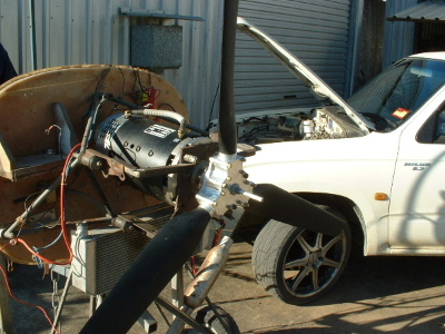

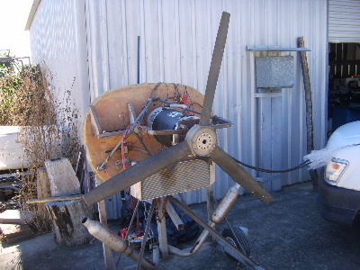

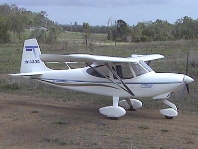

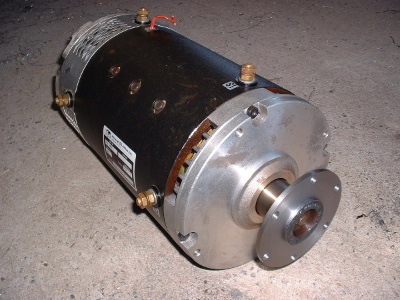

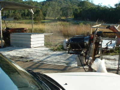

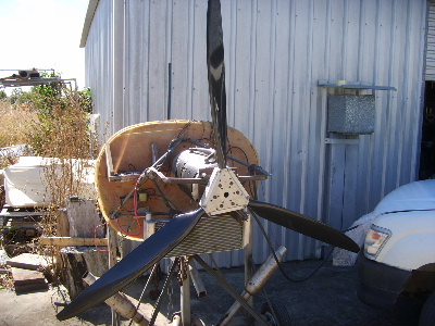

Swapped motors in the EV Hilux and with the motor out of the EV Hilux, we have done some initial testing for suitability &/or feasability for use in small aircraft.
While the test was exciting, it also was dissapointing. The motor could only reach 1500rpm, 2000 needed. The motor could only draw 220A. The rpm too low to allow more amp flow. Batteries were at 150v. This test used the standard propellar normally used on the aircraft. The pulling force only reached 92kg, just over half of the Subaru EA81 engine with a 2.5:1 reduction drive.
This motor would be good if we used a reduction drive, but we were hoping that we could do it direct drive. We changed the pitch of the propellar with some increase in pulling power. The next test will be with a shorter prop, smaller diameter.

Problem appears to be not enough torque at the RPM. But when the RPM is increased by decreasing pitch, then the motor can accept more current, which results in greater output power.
We tested some other props, all varied in diameter, but smaller diameter than the original test. The results were just as much dissapointing. There was slightly more gain in thrust with the smaller props taking more amps at higher rpm, but nothing to get excited about.
I have no problem (in the right gear/speed) getting 500 amps at 150v to the motor in the Hilux, but could not get that amount of amps with any of the props. Voltage was no problem - 150v
The batteries cannot be the limiting factor, volts or available current. These Powersonic AGM are capable of delivering some 2000? amps.
Motor, not enough grunt. It has a peak of 75kw. We could not get that much.
The next test was done some time later by Foxcon. I was not there. 6 cheapy lead acids were connected (72v) direct to the motor and the thrust was similar to what we had acheived through the speed controller.
Then 12 of these cheapy lead acids were connected (144v) direct to the motor. The thrust pulled the scales to the end of the slide (200kg of force), and nearly blew the fellow over that was standing at the back to read the scales. He tryed to push the scales back but it was hard up against the end, it was not going to budge. I wish I was there. That would have been so good to see.
So........ this proves that it is not the motor. Could it be the speed controller ?????

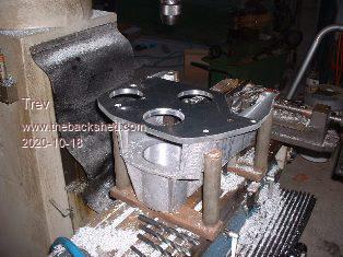

About the suggestion of Re-drive (previous post). As said above we were hoping for direct drive. As for sourcing.... no problem.... I make the Re-drive, cast and machine, see http://www.foxcon.com/Reduction-Drive.html

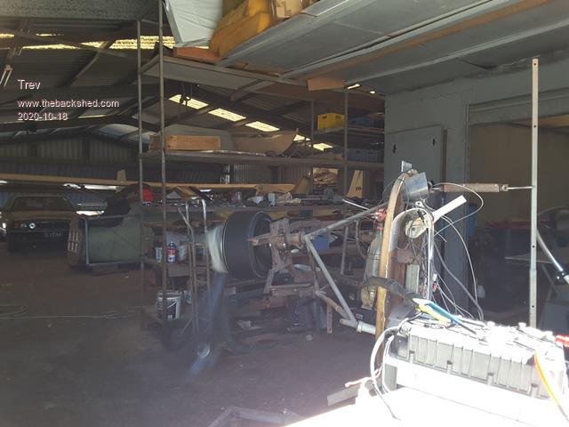

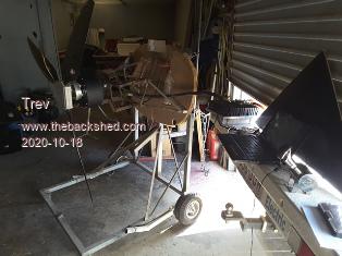

OK....now for an update

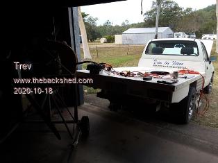

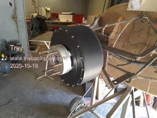

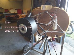

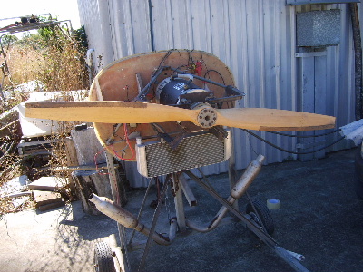

In Sept we tested a QS motor, 12kW rated vehicle hub motor. Rated to max 1480rpm and said to be higher than 350Nm of torque. While the rpm is lower than we wanted, thought it would be a good motor to run a test anyway.
Using the standard propeller on different pitch angles. Battery voltage of 155v.
28 degrees    1340rpm max    213A    pull force of 84-85kg
23 degrees    1378rpm max    180A    pull force of 84-87kg
18 degrees    1440rpm max    140A    pull force of 78kg

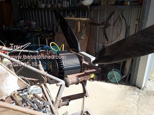

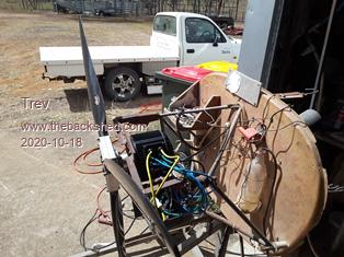

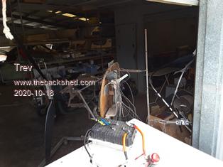

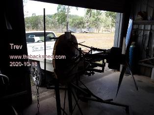

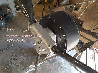

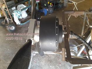

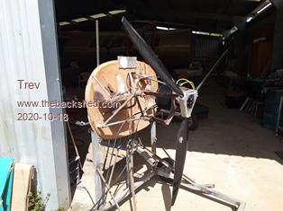

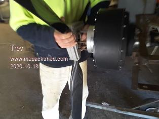

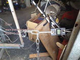

Today was testing a Golden Motor 10kW
With factory settings in the speed controller.....
Battery pack at rest 53v and under full load 46v.
Standard propeller.
Pitch angle 12 degrees    219A     1950pm    pull force of 96kg
Pitch angle 15 degrees    not as good as 12 degrees.
This so far has the highest pull force and the least draw of power. Seems too good to be true, but that's what we measured.
